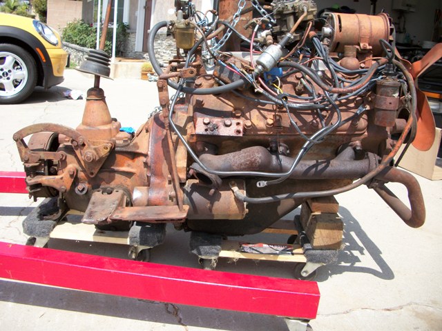

I’m not sure anyone had a concern about this other than me but, I did find that a carrier specific gear change hat would bolt up ok to a non carrier trans housing. I know that wasn’t what I had originally been asking about when I started the thread, but it is still good to know info. I know this pic shows a lot of non original stuff going on in my engine bay like the 8BA engine to the wrong color trans and on and on….. Thanks for the loan of the top hat Mike.
