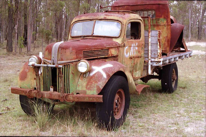

Default old Kingaroy photos
Here is two Fords showing both types of wheel fitted. These were taken at the late Ken Hugh place at Kingaroy Queensland some years back now.
Have yet to find a Chev photo with enough detail to see the wheels used.

Default 3rd type?
Is this a third type of 18in wheel fitted to a modified experimental Chev. Look like 10 studs to the brake drum
Old 13-05-12, 13:31
hrpearce's Avatar
hrpearce hrpearce is offline
WO8 C15A 142736
Posts: 1,958
Interesting photo Cliff. The Chevs I've owned one '48 and a '75 had five studs on the front and ten studs on the rear. The front had a plate that covered every second hole.
Robert Pearce.
Old 13-05-12, 13:31
Ganmain Tony's Avatar
Join Date: Jul 2009
Posts: 1,246
Default Good shot..
I think in that 2nd photo Cliff, the rims are Blitz 20 inch.
That may be what you were intending to illustrate.
Fewer bolts in the outer diameter ring than the 18's pictured above.
Good example of the 5 stud 18 in the first photo.
