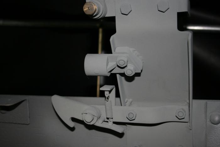

Default Aerial hooks
When the aerial is in the down position it is held in place by a hook mounted level with the division plate, its folded 4mm steel with a moulded rubber hook to protect the aerial.
I've made one copied from an original, it came out pretty well I think. I moulded it the same way as the original so the detail is correct to that.
I might make a small batch if there is enough interest, see photos below of mine and an original in place.
Trivia fact of the day, the Universal had the hooks facing in whereas the Scout and AOP MK1 had them facing out.
Ben

Old 07-05-13, 00:01
Ben, Nice job again!
I haven't seen that photo or mount arrangement before. Interesting low numbered carrier. Experimental?
