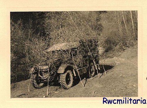

Futher to the thread CMP Umbau-Wagen, here's a picture recently sold on eBay (Item #2259320882, sold by rwcmilitaria), showing (at least) three Morris-Commercial CS8's captured (at Dunkirk?) and rebuilt as Kübelwagen or personnel carrier trucks by the German Army.
The conversion seems to be different again from those found on CMP F15 trucks.

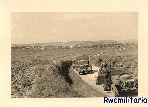

Mike, here's another one. This one must be based on a Quad, quite an elaborative conversion. Again, a type of bodywork I have not seen before. Apparently it was all worth the effort, maybe the Morris' were simply very reliable?

Young Ballard says they're very early CS8s with the 3 piece rims, so Dunkirk capture is likely, in fact virtually assume its always the case owing to the numbers left behind.
They have a Wehrmacht windscreen though amongst other things. I have sent the image to The Baron Paulus von Hocking, he might well be able to identify the unit, date and place.
There seems to be circumstantial evidence that the M-Cs were well regarded by the Wehrmacht and hence the effort in making engineered bodies for them.
Again, young Ballard pronounces this as an early C8 quad with the steering flutter prone 20" wheels using 3 piece rims. They must have re-built everything here as the mudguards are of strange German pattern.

Second photo from top. Note unit marking on the mudguard.
In this case 1st Cavalry Division which on 28th Nov 1941 was ordered to reorganize as 24th Panzer Division.
This reorganization was carried out in France Feb-Mrs 1942 in Mailly le Camp and Coetquidan.
The Division was sent to Russia and later whiped out in Stalingrad. A few elements outside of the Stalingrad pocket were brought to France where the Division was reinstated.

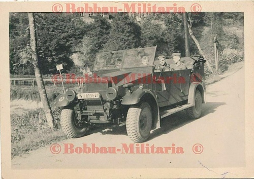

Another photo of a Morris-Commercial fully converted to Kfz.15 standard, with the typical triangular doors. This is a CS8 15-cwt, not a PU 8-cwt, right?
Nope, its a PU.

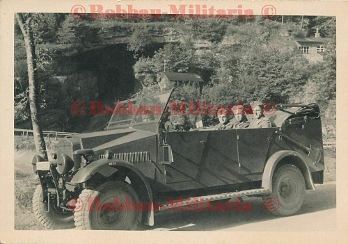

Again from the Axis History Forum, another picture of a Morris-Commercial PU 8-cwt Kübel.

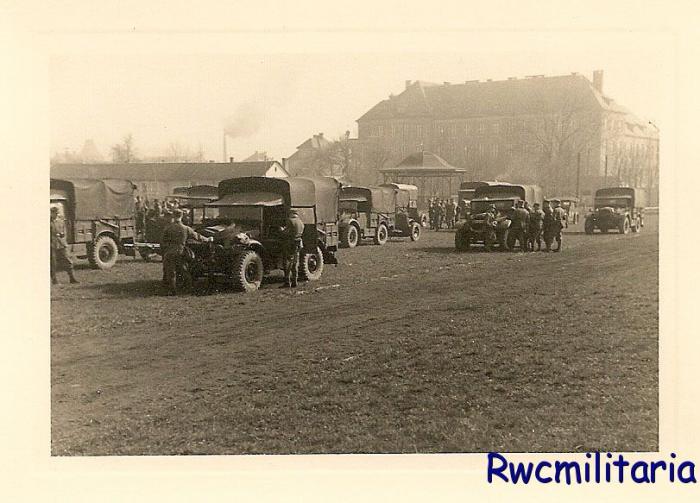

Further to the first picture of this thread plus the ones posted by Keith, which shows a PaK tractor conversion, here are a few pictures of a similar conversion.
Contrary to the first variant above, this one has retained its original GS cargo body, albeit with an ammunition locker fitted to the front headboard. This second version also has its British front window replaced by a German one.

One for you Mike, it's in the wrong hands though.
Seller has a couple more pics with CS8s too.
http://cgi.ebay.com.au/Port-Photo-Ge...item45f80cb778
Ryan,
Nice find, I moved your post as it is more related to this thread (Mike would never convert his CS8!).
They are PaK tractor conversions as seen in the pictures above. Looks like at one point in time the Germans had more CS8's in service than the British!
