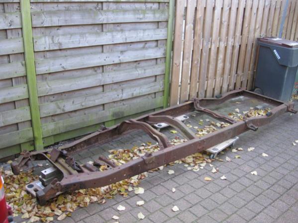

The real start of my project was to get the frame blasted. I still have to get used to this heavy stuff ( even though this is the smallest of CMP's), but with some creativity I was able to fit the frame inside our van, which saved me the trailer rental.....yes, I know...the Dutch way
I removed as much of the seperate fittings as possible and after blasting had the frame coated in a black primer.
Fellow C8 owner Nick Bullock helped me out with my frame by the way! thanks again Nick.

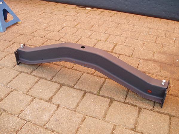

Attached you will find a picture of the Crossmember that was under my truck when I bought it. The next two pictures show the corners of the replacement after the frame was blasted. I wasn't happy with the small rotted holes and decided to weld in some fresh steel and also replace the nuts and bolts.

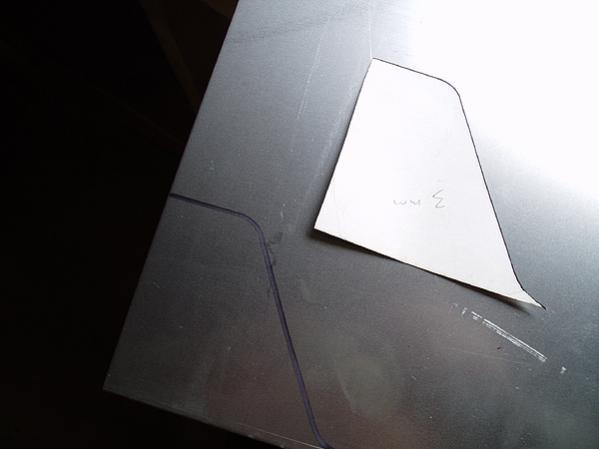

I first made a template from cardboard and than transferred it to steel. Forming the replacement bits was largely a matter of trial and error with a hammer and wooden blocks. The crossmember is slightly angled towards the front of the frame, so the replacement bits left and right are mirrored. I cleaned the inside of the crossmember as much as possible, treated it ith Fertan and coated it in primer, before welding the new bits in.

The cross member is bolted in position with four bolts on either side and two extra located on the bottom. I tag welded the replacement steel in place and testfitted the cross member to see if the holes lined up. Thankfully my measurements were correct and ould proceed with welding and bolting the thing back into position.
