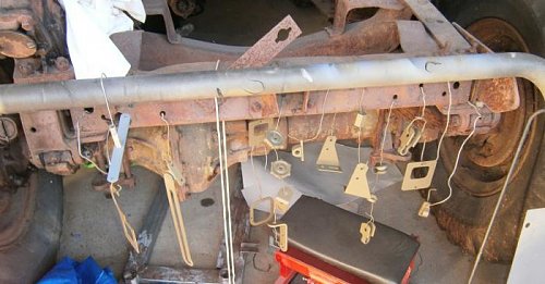

Hi Tony,
Your large fishplates were posted today. Unfortunately I don't have the little brackets for the top. Evidently they didn't come with the pintle hook assy I bought. I must have been imagining them.
However it looks like you have a pair on your F15 chassis, judging by pic 1 below. You could pinch those ones, although it would probably be less work to copy them and leave that crossmember undisturbed.
You'll note on your F15 chassis that the rivets holding the rear spring hangers also hold the little top brackets in place. It's the same on all CMPs, even though the F15 springhanger itself is different from 4x4 models. This will give you the correct position for your rear crossmember.
Depending where the previous owner drilled the spring hanger holes, you may not have enough chassis rail sticking out past the rear crossmember. Correct length is 13 1/2 inches from the rear edge of the spring hanger to the tip of the chassis rail (measured at the lower edge of the rail).
This is more than just a cosmetic consideration - if you ever want to fit a pintle hook you'll need enough chassis rail sticking out (see pic 2). You can get by with as little as 7 inches (no wonder my girlfriend left me ) if you're prepared to butt the pintle hook mount hard up against the rear spring hanger. Personally I'd prefer to drill new spring hanger holes to get the full 13 1/2 inches, for the sake of appearance. I imagine your chassis repair mob could do a good job, and maybe even rivet everything instead of using bolts.
Good luck with it all Tony, I look forward to seeing the result.

Hi again Tony,
It has just occurred to me that this pic demonstrates clearly why you'll need a fatter rear crossmember. Imagine sliding this F15 rear crossmember forward inside the chassis rails, to a point underneath the tyre somewhere. As you can see it would be very sloppy inside the chassis rail channel, because it's much wider there, due to the taper.
This is exactly what you are doing by shortening your F60L chassis by a massive 43". Remember that the rearmost 7 foot or so of a blitz chassis is identical on all models, so in looking at this pic, you are looking at an F60L chassis.
I realize it's difficult for you to visualize on your chassis, because the rear section is no longer there. Hopefully this pic helps.

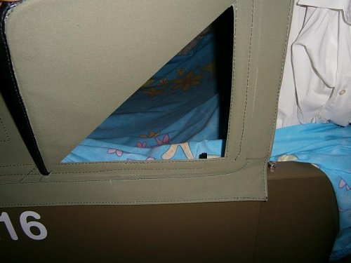

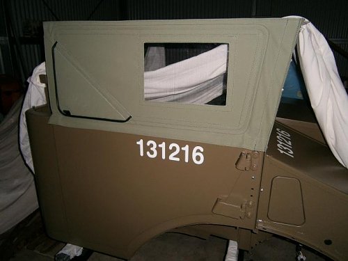

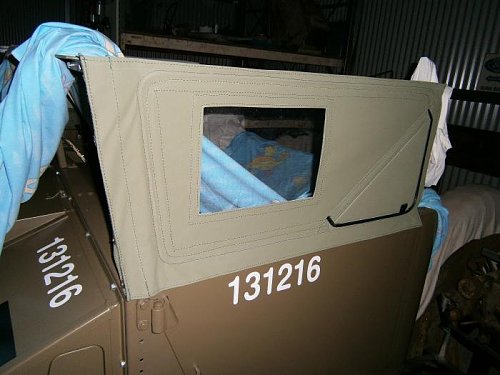

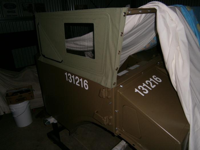

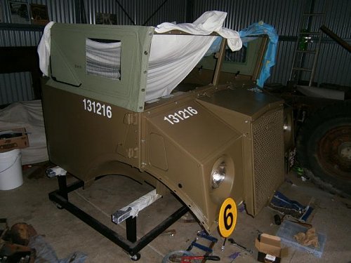

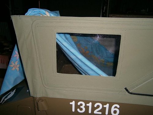

Firstly, Tony, NOW I get what you meant, and I am very relieved that I don't have to worry about chassis width. The length is enough of a headache as it is. I have read you PM, and thankyou!
This afternoon I got the canvas side curtains from the upholsterer. I am glad they are back so I don't need to write 'upholsterer' for much longer. I often spell it wrong and have to go back to fix up.
Name:	Side curtains 1.jpg
ID:	49801 Click image for larger version
Name:	Side curtains 2.jpg
ID:	49802 Click image for larger version
Name:	Side curtains 3.jpg
ID:	49803 Click image for larger version
Name:	Side curtains 4.jpg
ID:	49804 Click image for larger version
Name:	Side curtains 5.jpg
Anyhoo, I am pleased with the finished product overall. My only criticism (that word's as bad as upholsterer ) is that I wish I had asked for a green piping around the access flaps. The originals did have black too, but it seems the black stands out far more when it's new. Maybe I could dull it down with a little brown boot polish? Probably won't do that because I am likely to get some on the canvas.
For those who are overly observant (yes, you Keith! ), there is one fastener missing on each side of the windscreen support panel. I have two from the upholsterer (oh...that bloody word), but have not put them on yet.
The slight warp of the canvas in front of door won't be as bad once the window support is moved back a little when the roof is to be attached. I measured it, to find it is too far forward, but without the roof to bring it to correct position, I will leave it where it is for now. If the canvas fits alright now, it should fit a bit better with roof on.
The magnetic catches for the access flaps work as good as I had hoped. You wouldn't want to have used 'regular' magnets though, they wouldn't have been strong enough. I believe the little metal piece I welded to the frame where the magents are to stick to, caused a nightmare for the guys (notice I didn't use the word upholsterer......oh crap!) to sew around and they had to make a bit of a detour around this with one of the stitch runs. That's my fault entirely, and I will have to live with the result.

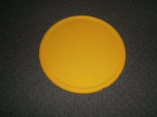

This afternoon I received the bridge loading plate I had ordered from Axholme Signs in U.K. See: http://www.axholmesigns.co.uk/
Name:	Bridge Loading Plate 1.jpg
I had ordered a bridge plate, number for same and a reusable stencil for the fuel tanks saying "Caution, Do not overfill, Allow for expansion". The CMPs may or may not have had such a caution, but I will be greatful of the reminder with each filling of fuel. Lets face it, being a V8, it will happen often enough. Axholmes even sent an extra copy of the number sticker for bridge plate, as a spare. My reputation must have preceeded me!
The bridge plate is NOS and nearly perfect condition, with only a couple of very small areas of paint chipped around the edges. I will see if I can find a flat yellow paint tomorrow at the paint shop, to touch these areas up.
Care to place bets on my chances? Line marker yellow may be suitable. It's only for the damaged bits after all.

Just a question on the tops , what happens when you open the door since the line through the hinge will cause the top to swing inwards, stretching the top flap. the originals ,with square top frame had a folded flap to allow for movement ?? .
macca C15 C15A
  #516
Old 08-06-12, 15:53
Default Bob
Helllo Bob,
That is an excellent question, and it was something I had worried about the whole time these things were under construction. Because of the chain of events as they transpired, I had no opportunity to test fit the old canvas.
If you recall, I had taken the curtains in for a quote, accepted the quote, had the guys remove the steel frame for me to 'clean-up', and then found that the two original frames were different. At that point I called a stop to any potential work on the canvas until I could make new frames. In order for this to happen I had to have the doors on the cab to test frame fit. I figured I might as well finish doors completely, which meant lots of work, and considerable delay. In that whole time, I was fully aware I would not have any chance to test the fit of the canvas itself (they were already cut off the frames before this).
For some reason I had felt it would be the design for the canvas tops to go a little slacker with door opening, but I was wrong entirely.
In order for the guys to make these tops, they required some measurements from me. That being, distance of canvas from front edge of the steel frame of the curtain to corner of the windscreen support frame. Also needed to know the spacing of the fasteners along the windscreen support front edge. In my usual style, I gave them very precise measurements because I didn't want the thing to look loose once fasteners were clipped into place. Oh boy! By now I should have realised nothing is precise on these vehicles, and allowed additional length to be sure, but I calculated what I though was the exact size then added a 1/2" for good measure. I'm very pleased I did too.
When the doors are opened, not only does the whole thing NOT loosen, it actually tightens up a little bit! Not enough to cause any problems or damage paint or canvas, but it can be felt if you push on the canvas before and after opening the doors.
Here's where serendipity stepped in on my side. You may remember I indicated the window support panel sits slightly too far forward at the top? As luck /gods would have it, that is the reason why the tightening of the canvas occurs to the extent that it does now. The window panel top needs to be moved to the rear approx 1-2cm for roof to fit properly, perhaps even a little more. I have worked out that once this has occured, the tightening of the canvas should not occur anywhere near the extent it does now. Bearing in mind that it is quite OK now, the whole scenario should be almost entirely resolved with roof on and the windscreen panel in the propper place.
Here's where you can learn from my mistakes. Always allow more than the 'minimum' when measuring anything like this on a CMP, and try to make sure you always have the opportunity to test fit anything before disassembling for repair. I should have known from the fitting of the doors some weeks ago, that NOTHING is precise in fit or construction. To attempt to make something so precise that it is at risk of failing is just asking for trouble. In this case I got away with it, but it could easily have gone the other way if I had, by pure chance, managed to have the windscreen support panel sitting in the correct position at time of measuring, or worse, if it had been sitting too far back. In that case the curtains would need to have the front strip cut off and a new bit added for extra length. Wouldn't that have looked great?

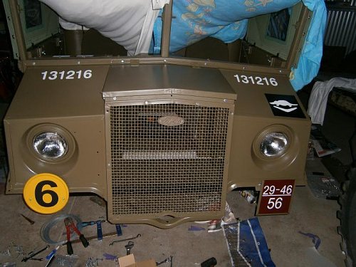

Default Signage now finished
As usual, it was into town this morning, despite the rain & cold!
Did manage to find two suitable yellows at paint shop, so I can now touchup the paint chips on the bridge plate.
Name:	Cabin front signage 1.jpg
ID:	49844 Click image for larger version
Name:	Side curtains 6.jpg
Speaking of bridge plate, it's finished now. So is D ^ D markings on door tops.
Name:	Cabin front signage 2.jpg
All signage on cabin now completed, thank goodness. Apart from a thorough tidy of the workshop, that's the sum total of todays output.
I still have to finish the repair work on radiator air duct, after that its about time to return focus of attention back to chassis work.
Tomorrow I am on the road to retrieve some parts a couple of fellows are holding for me. Into Brisbane first and then up to Warwick way. From memory, it's a 8-10hr round trip from home, so don't expect to hear from me tomorrow, unless I show the bits I have brought back

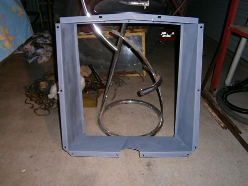

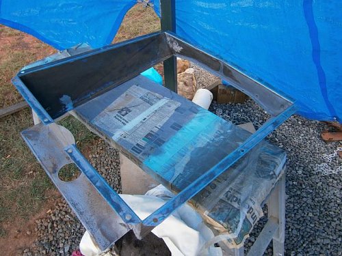

Name:	Air duct 2.jpg
ID:	49896 Click image for larger version
Name:	Air duct 3.jpg
ID:	49897 Click image for larger version
Name:	Air duct 4.jpg
Didn't get a lot done yesterday. It was too cold to even put decent primer on the radiator air duct once I got the welding finished. Managed to put a light bit of etch primer, so long as I used the heat lamp to warm the panel before and after spraying.

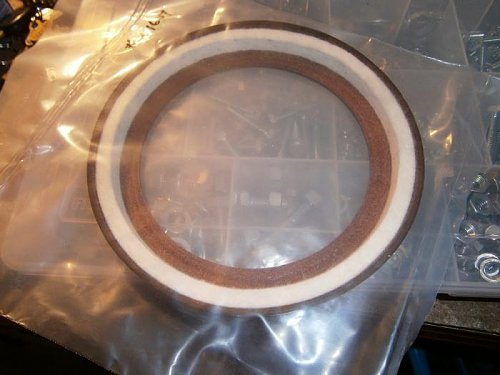

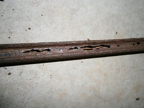

Amongst the things I retrieved Sunday, were two window frames. They both looked to be two of the most inact I had seen..............that was until I pulled one apart and found it completely rotten inside. Still, they didn't cost me anything, and perhaps the other one will be better. If nothing else, it has shown me how to get the glass out without breaking it. Only the bottom portion was rusted badly so I may use these to make one good one from both (they are both passenger side).
Name:	Booster seals.jpg
Further items retrieved include (but not limited to): The 2 window frames, a good brake booster, repro reflectors x 4, Ford generator, some switch plates, brackets for side curtain bag (that hold the bag to cab rear, I think), V8 distributor caps, spark plug conduit tubes x2, Ford gearbox..................and last but not least............a new set of seals for the Ford vacuum brake booster. Not NOS, these were made in last couple of weeks by a company in Brisbane. They were not cheap, but very important to rebuilding the booster!

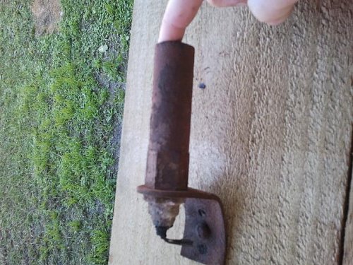

I have downloaded the convoy light photos. Here they are!
This is a photo of a Canadian convoy light I saved some time ago. It looks the same to me! Bracket would be easy to replace.
I have written to Dean a little while ago, to thank him for the window frames. I mentioned the first one I started on, a few days ago. That one was disappointing and would require a great deal of remedial work. The second one on the other hand, was an entirely different story, I am pleased to say
I will write more about that in next posting. I took photos to post too.

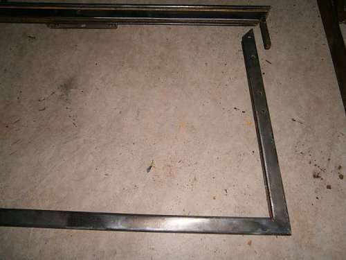

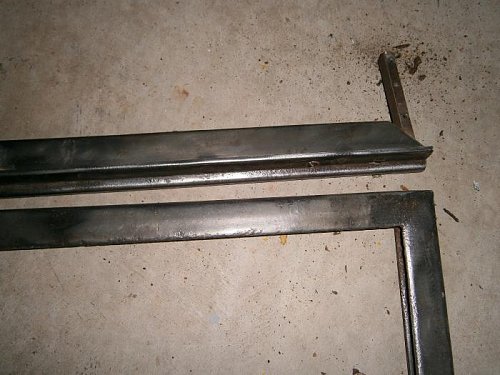

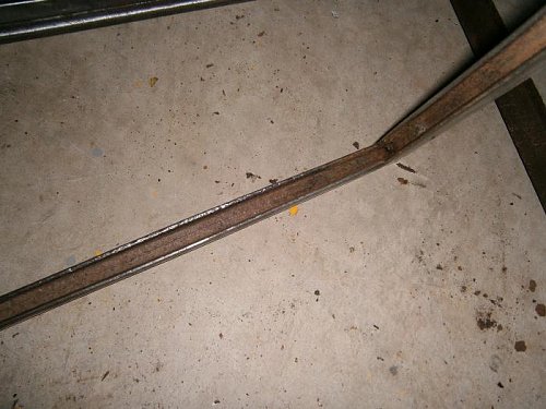

Old 16-06-12, 12:45

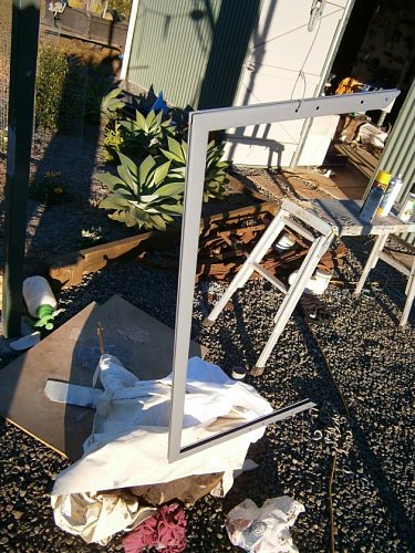

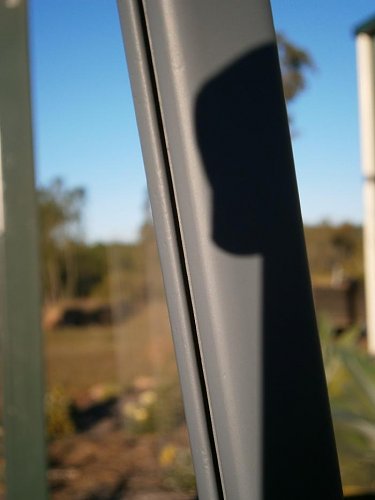

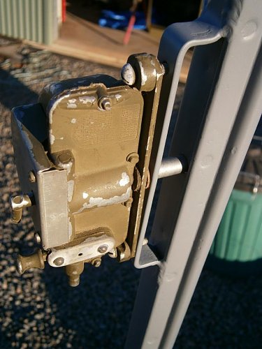

Default Finally. A good window frame.

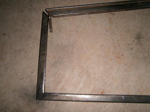

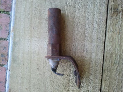

After a disappointing start last weekend, the second of the window frames picked up, has turned out to be a little treasure. This one has no holes in it anywhere on the outside, and I don't care about the two breaks in the window channel track. They will fill with Butyl sealant
Name:	Window frame - passenger 1.jpg
ID:	49963 Click image for larger version
Name:	Window frame - passenger 2.jpg
ID:	49964 Click image for larger version
Name:	Window frame - passenger 3.jpg
ID:	49965 Click image for larger version
Name:	Window frame - passenger 5.jpg
I didn't dare expect anything other than flakes of rust, requiring a bit of welding at best. But I was pleasently surprised.
Name:	Window frame - passenger 6.jpg
A thorough beating with the wire cup and a few minutes work removing hard silicone sealer from the window channel, showed this to be best one I have gotten to date. Lathered all the rust with a good quality converter and put it to bed for the night.

  #530
Old 16-06-12, 12:47
Default Bracket
This is the one you're after:
I may also have the original tail light wiring loom for Ford CMPs.

Old 16-06-12, 12:53
Default With the light
This is what it should look like:
  #533
Old 16-06-12, 12:56
Default Bracket & Wiring
.......I may also have the original tail light wiring loom for Ford CMPs.
It looks like the one on Andys light may be usable. I thought it looked like it had been butchered, when compared with the bracket in my other photo, but it looks very close to your photo.
Re Wiring: Did you forget about looking for the front wiring for me? Remember I have a Cab 12 headlight wiring harness and need a cab 13 set instead. For that matter, I need ALL the wiring for a cab 13 With tax time coming up, i'm sure I can splurge for wiring harnesses!
Let me know what you got that's in good condition, and prices please. I'm sure we can come to a deal

Old 17-06-12, 12:25
Default Window frame x1 - ready for painting
Name:	Window frame - passenger 9.jpg
ID:	49978 Click image for larger version
Name:	Window frame - passenger 10.jpg
Didn't get color on the window frame, but got to primer stage.
Name:	Wiper motor 1.jpg
I bought a pair of these NOS wiper motors about a year ago. This is the first trial fitting.
They will do just fine, and they work too. At least this one does.
The other is still sealed in it's wax covered box.

Just before coming inside, I cut and cleaned a short length of window frame channel, to take to rubber shop tomorrow, so I get the right size rubber seal. There is a fair chance they will have the right seal stock already in store.
I have found an issue with the window frame hinge mechanism. This being that the window does not want to swing to extent required for fully closed position. Something in the two pieces is stopping the free movement. It's not rust in the channel, and the two pieces slide along each other freely because I put a lot of time into the cleaning of the grooves, but window does not want to close fully. I can't see anything bent. Nothing looks out of place but will budge. I have a week to work it out, because it The window WILL be painted next weekend!

Hi Tony
Things to check on Windscreen Hinge:
Some of them had a soft gasket between the hinge and the frame that moves the hinge out about 1/16 of and inch.
There is a notch in the hinge fore the wiper shaft if the notch in the inner and outer don't line up this can cause a problem.
Are the screw heads that attach the hinge to the frame sticking up in the hinge when it is closed.
I'll look at mine today to see if I can spot any other possible causes.
