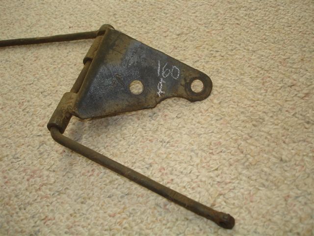

Bear fur or hard wood I would be keen, any chance of the measurements for the throttle linkage also.
Lew
Old 26-07-12, 13:17
Default Lew
The measurements are from the spindle center to the hole center.

Lew, I saw one of those throttle linkages on it's lonesome in a box up in Hamilton.
