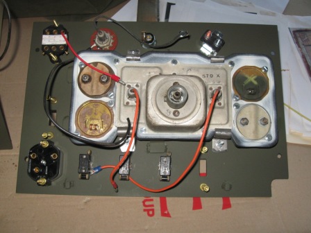

Default Dash unit assemblies
Over the last couple of years I have slowly (and I do mean slowly) put 2 dash assemblies together. It has taken awhile to find and collect original toggle switches, NOS dash warning lights etc. Dad and I had many gauges, so it was a matter of seeing what we had, repairing them with new decals, finding NOS gauges at swap meets and then putting them together. No rush as the vehicle does not need them yet.
I had an original dash board that I copied to make another dash board, an early dash without the switch guard that will go into hull 731.
Just some pics to show my progress.
I came to a stand still with the wiring as I think it will be easier with the dash in the vehicle and a loom to conect to.
I have gone with the gold surrounds with red stripes as I have seen numerous BGC with this in their dash assemblies, not sure if this is 100% correct, but I think at the time they did come like this.

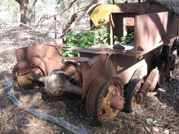

Posts: 606
Default suspension off, hull down
Using the angle grinder, removed the plate inside the engine rails, at the forward end of the engine bay that hides the tube shaft. This plate was rusted, and having it removed will now let me replace the fuel change over bracket rod. I think this was placed in to the hull and then welded in. In time I will get another plate lazer cut and fit the small metal brackets and leather dust boots.
Commenced to remove the seats in the front, removed all other fittings in the front, now the only items left are the seat mounting blocks welded to the floor. Will have to heat and remove the broken bolts later.
Removed the suspension from the hull and have lowered it down onto the tyre/vehicle dollys with many blocks of wood for support. I found that I can use the 2300kg pallet jack to lift and move the front of the hull and can support it on my jack stands. Have now moved the hull into the welding bay of my workshop. One person can move it around the workshop, two people ensure that it does not run into things causing damage. I now have many pallets around the workshop to store and move items around, finding it very handy. It also keeps the kids amused.
eng plate.jpg   Darrins Photos 002.jpg   Darrins Photos 003.jpg   Darrins Photos 004.JPG

Bob Moseley (RIP)'s Avatar
Posts: 2,620
Default Carrier Panel Variations
Hi Darrin - interesting and very topical subject with me at the moment. Over the years I have been building these panels with the learning process on a continuous basis. My current version, the brown one, is what I build and that is based on the two images out of a Carrier manual. One of your panels is similar to the 1943 one other than the colour of the fascia plate and striping.
Now why I say this is topical is that a few days ago "Along Came Jones" with a panel variation I hadn't seen, see other image. I was initially hesitant that this was an original configuration but Colin assured me this panel came from an original, uncut and unmodified Carrier. When I broached the subject of the speedometer showing the gear/speed quadrants, my attention was drawn to a small plate on the top left of the cluster holding plate. This plate correlates the speed/gear ratio of the Carrier. I had never seen one of these plates so that was an education. I have yet to see one in the flesh but that is only a matter of time. I see on your holding plate a spot for this small plate.
I cannot now be definite on which is the correct configuration of the cluster. I will stick to the two Manual images unless someone requires something different. The variations obviously depended on the manufacturer and their interpretation of what was required.
I thank Colin for furthering my education and research in this area. Back to the drawing board.

Default speed plate on dash
Hi Bob,
yes the dash had a speed/gear plate on it, I removed it to see the paint underneath and so that it would not get damaged by sandblasting.
The original plate will go back on, I did make some copies of the plate in fiberglass resin, as I will place a copied plate on to my newly made dash. I have several spares in case they gat damaged.
I did try and sell some of the copied plates at Corowa but nobody was interested.

Cut the back panel shelf that holds the stowage boxes on the rear of the hull off with Oxy, now to start grinding the off-cut dags. I removed this as it needs to be replaced, I would take a guess that this vehicle has had a minor rear end accident when in service.
The shelf for the stowage boxes is there and would accept the stowage boxes but it is badly mangled and out of shape. You can also see where it has been re-welded back on to the armour of the rear of the hull and brush painted green.
Removed the last of the little hull brackets and measured the hull mounting blocks in the front of the hull. I think it may be easier to make new mounting blocks and replace them than drill and tapping and trying to re-thread rusted holes. I did manage to get all bar 1 bolt out of the seat mounting blocks, so they will stay, will look at replacing the smaller blocks with the 1/4"holes.

During the week rang and organised to recover the engine on the weekend.
Went out to the farm after lunch to prepare the engine for removal from the truck chassis. 1 1/2 hours later in the cold and drizzly rain and all wiring and bolts removed or cut with the oxy. Managed to slide the engine forwards 1/2". All good, unfortunately the farmer has not arranged a floor crane for the lift, so will have to wait until another weekend to lift it out.
The radiator may be from a BGC, it has been recored but the lower tank and outlet pipes are stepped and I think this is a feature of BGC radiators. The overflow pipe goes down the left side just below the top tank. This may have been changed to suit the truck application.
I cut the remaining bolts that hold the roller assembly in for the centre tube axle, then spent another 20min pulling & pushing the axle back and forth to get it out of the hull. Figured out that it is a very tight fit and any grime and rust scale slows it down as it moves through the hull and the casting that holds the rollers. There is approx 1-2mm clearance between the tube axle and the casting. Once cleaned up, out it came.
1943 MBT trailer

Old 26-08-12, 13:50
Posts: 606
Default Collected the engine
After lunch went out to a farm and collected the engine that I prepared last weekend. The owner had a small workshop crane that we positioned on a ply sheet. Once slung, up and out it came. In the trailer and strapped down.
Asked the farmer if he still required the radiator, after a long thing about it, he threw it in the trailer. Due to all the rain, the paddock was very wet and the car slid around getting into the paddock, now with the extra weight we nearly slid into the fence. The boys loved it as the wheels spun in the mud and cow poo. Somehow managed to stick a small branch through the RHF mudflap and guard of the car- wife will not be happy, I know I'm not.
So on the way home, went via the car wash to clean the mud & poo off the car and trailer.
The pictures show the engine in the trailer with myself and one of my little helpers, the other helper was taking the pictures.
