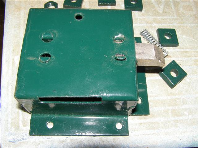

Today I used the angle grinders to make the tongue of the catch out of a piece of 16mm key. I still have to make the handle and cut the grove for the handle to pass through the tongue.
Can anyone tell me if the spring is let into the tongue or just droprd into the gap?

I finished making the parts for the hatch catch today and painted them.

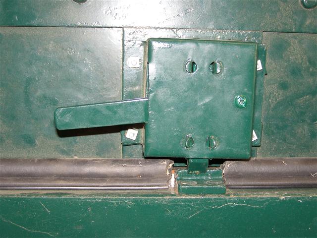

Todays effort, The catch was assembled and installed and the mounting bracket for the tack holder fitted.

I had to ajust the hatch catch as the toung didn't get enough grip to stay shut on rough roads. While I was in the shed another small part was painted and put in the dash.

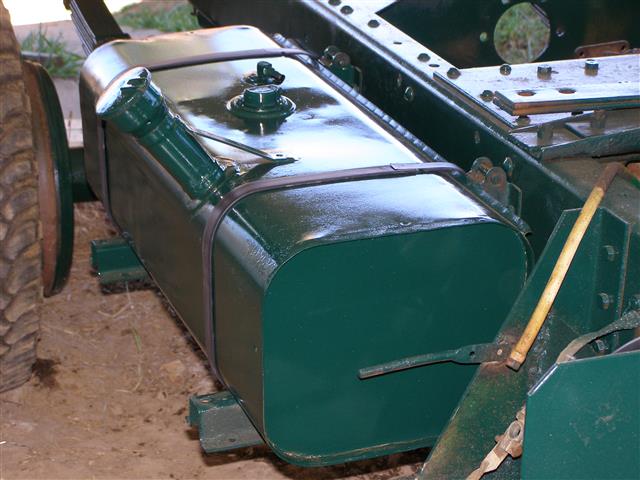

Both tanks I have for my blitz are the same size but the filler necks are different distances from the front edge and onr has the bracing on top and the other underneath. I can get both tanks to fit just wondering why the difference.
Looks like you might have 1 Ford tank and 1 Chev tank
The Chev tanks I have are the larger spacing with the round cut away fuel sender
The Ford ones I have are 6 inch spacing with below bracing and should have round flatter type fuel sender
Have a good one
Andrew

On the Chevs they have a mixture of bracing on top and below with the larger spacing on the C15A and sigvan and a 2 inch spacing and below brace on the C60L, I am assuming it is to allow for spare tyre removal without wiping out the filler
The Ford tanks I have all seem to have 6 inch spacing with below brace
SO no idea
Probably a model difference thing
Have a good one
Andrew
