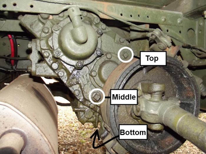

Heya,
I know the transfer case is a bit peculiar on mine, but it looks from the outside very similar to the traditional large one. I'm changing and checking the fluids wherever possible at the moment to get her in tip-top condition, but the transfer case has me a bit stumped. I don't want to drain or fill until I know I'm doing it right
So there's a drain plug on the very bottom - got that one
Theres another plug going into the case close to the left of the parking brake pad that's about the same size.
There's a small plug higher up going into the case above the parking brake pad.
There's another plug on the opposite side going into the upper of the declutch carrier (if I'm interpreting the manual right, the bolt on bit that heads toward the front axle).
MB-F1 simply says "put 2 pints in" and not a lot about where they go....
If I'm right I suspect the upper is breather hole so you can drain out of the bottom nicely, then fill at the middle one that's close to the parking brakes. It doesn't look nearly high enough up the case to take 2 pints though.
Can someone give me a yay or nay on my thinking?
Thanks!
Lauren

some photo's, showing the locations of the plugs.
F22 Transfer Case (Rear).jpg   F22 Transfer Case (Front).jpg   F22 Transfer Case (Declutch).jpg

Hi Lauren
There actually are some Service Bulletins on this issue of what height to fill different transfer cases in different application situations.
They all boil down to this the fill to the bottom of the filler hole you have marked Middle in your photo.
The Service Information Bulletins contain a wealth of information and updates to what was in the manuals. In general the design of the transfer cases and placement of the fill plugs started off having a much larger capacity than what was needed and because of the additional height of gear lube in the boxes a larger leak problem. In some cases the bulletins even recommend drilling and taping for a new lower filler point. Exceptions to the lower level of gear lube were when the winch was being used extensively.
In particular Bulletin B-55 dated May of 1943
Now as to the filler point on the front of the case on the "declutch" this really only needs (in my experience) to be used if the transfer case has been disassembled, hence really drained of all lube. On some transfer cases if you remove that top front plug when the transfer case is hot the lube will actually run out because the filler plug on the back is higher.
Obviously it is how much is it leaking, if the transfer case is over filled the leakage gets worse. I consider that things are normal when I can top off the transfer case in the spring and still touch lube with a crocked finger at the end of the summer. Watch out though transfer case and lube maybe hot, like 140F after several hours of road driving. If you are fortune enough to be able to park the truck in the same spot on a hard surface you can gauge how much it is dripping.
Tracking the temperature watching the drip marks is my way of keep an eye on things. I've now got records for all three trucks on wheel hubs, transmission, transfer case etc. A quick walk around the truck with an IR gun reading the temps when ever I drive the truck and hour or more and you start to spot stuff.
If your truck gets to the point where it is marking its territory with large puddles of oil or lube then you really have to start watching fluid levels very closely.
Hope this helps.

Thanks Phil, I'll give that a go tomorrow using the middle one to top up.
No serious puddles as yet (other than where I missed the bucket undoing the drain plugs elsewhere....)
Is there anywhere good to pick up the service bulletins? I take it they're different to the commercial versions (I've picked up some of the commercial ones, but they only seem to go as far as 1942).
