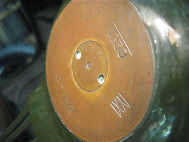

Working on a Champ at the moment that has the coolest steering wheel. Can anyone ID what the shell casing was originally. I'm afraid it's all gobbeldygook to me.

It appears to be 2 Pounder Richard

Richard,
Diameter, please. Looks like 18 pdr from the faint markings, but the diameter looks too small.
Markings appear to be quite elderly: much older than your 'Chump'
Mike C

Mike and Phil, thanks for your thoughts on this subject.
It will be a couple of weeks before I am back to this Champ (Mike you need to check your spelling, Chump indeed!)
Not sure that a diameter would be much help as it may well have been machined to fit, or at least to help the bog hold it in place.
I have a pic from another angle, but probably does not add much.
Rich.

It's Italian made in 1939 for their 47mm Gun (MORE INFO), so probably a good chance it came back from North Africa.
This was a dual-role gun that was both an Infantry Gun and an Anti Tank gun. In Italian, "Anti-Tank Ammunition" is Munitzioni Anticarro. Perhaps that is the meaning of the MA (or AM?) cipher, or perhaps it is a specific munitions factory?

Excellent! Thanks for that.
The 47/32 was encountered and used by Australians in the Middle East, and I think there is a captured example of the ugly little brute in the AWM's National Collection. It was on display in ANZAC Hall, adjacent to the CMP caravan, a few years ago but I think it is now back in storage at Mitchell.
The AWM image collection contains several images, eg 044455, 020088, 041998, 041999, P03799.017 which may be of interest to Richard.

Great Tony, Thanks for that ID. This steering wheel has caused a bit of interest in various circles (Oh dear), and the first question is of course what shell it is.
Mike, thanks for the pics, certainly an Aussie connection with this artillery piece, quite sure the guy far left is hiding a shell casing behind his back!

The Wikipedia article I linked to above provides a pic of an existing example at CFB Borden. While more probably linked to the Italian Campaign rather than North Africa, the Canadian example appears to have non-original wheels. Does anyone think they look like inside-out Carrier wheels? Compare to the AWM pic of the 7 spoke originals.

These pics show the AP round (base fuse) adjacent to 2Pr A/A (Pom Pom) in my collection.

Well, now we know what the rest looked like. Looks kinda bare without a steering wheel wrapped around it.
