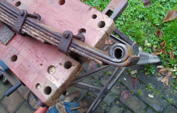

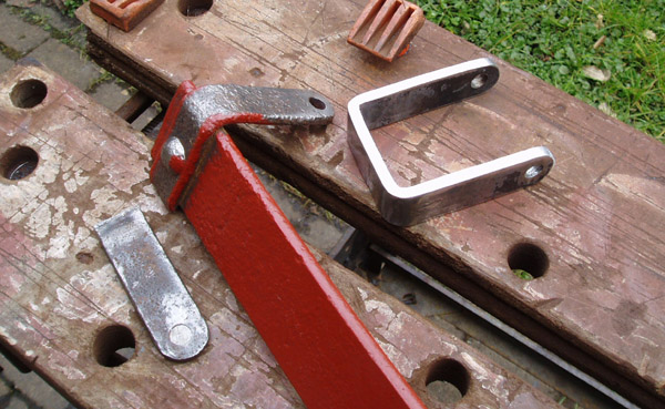

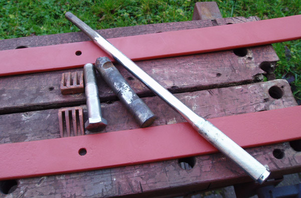

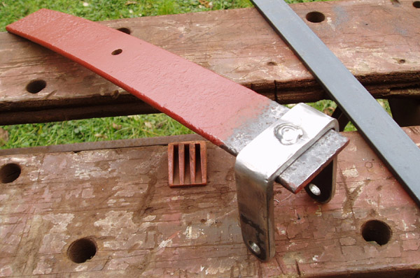

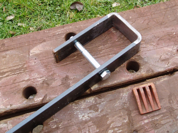

Attached are some pics of the rear spring work
One of the clips actually broke while removing the remains of the old bolts. Bob mentioned earlier in the thread that they were quite easy to make from flat stock, which is what I did. Some bending, hammering and drilling later the clip was done (and grinding as the flat stoch was actually to wide).
I used the grinder to cut the head of the old rivet. I cut a slight oversize hole in the new clip, chamfered the hole and welded the new clip to the old rivet. The lot was then assembled with new nuts, bolts and bushes/spacers.

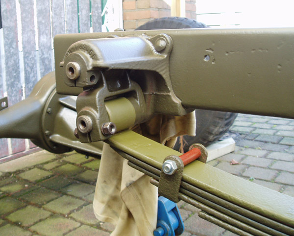

Installing was quite easy, although you have to make sure the spring pins are properly aligned before hammering them into the spring hangers! One pin slightly rotated and it was a bit of a *(&(* to get it a aligned to get the locking bolt in.
@ Bob. here you can also see the spacers a C8 uses to fit narrow leafs to normal spring hangers.
Two of the spacers from my C8 were pretty worn, so I had two new ones made by a machine shop, along with two brass bushes for the spring eyes. Earlier in the thread I mentioned that the replacement spring eye bushes were to small for the spring eyes...in the end this was only the case with 1 spring. Somehow this spring had slightly larger spring eyes....I guess it musy have been replaced some time during the life of my C8.
@ Bob (sorry...again)...Brian was indeed able to help me out Thanks! So, a 216 doesn't use a high pressure cooling system? Does that also mean the stress on the rad is less, so I only have to gravity test the rad in stead of pressure tesing it by an expert....? Or am I cutting corners there?
