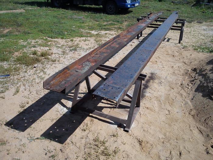

More pictures - rivets, press and the power station.
Vnukovo06.12.1200315.jpg   Vnukovo06.12.1200301.jpg   Vnukovo06.12.1200300.jpg   Frame09.12.00379.jpg   Vnukovo06.12.00324.jpg

After I see I can go well the second frame's time came.
It was in better condition so more parts came from.
Continue to sandblast and paint.

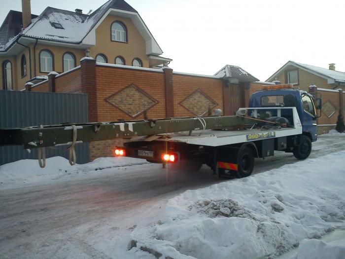

Needed to remove whole the frame from the cold shed into the garage because the cold time came.
Now it looks like on the last pictures, ready to put it on the bogie
24.12.2012.00400.jpg   24.12.2012.00407.jpg   Frame12.2012_0867_resize.jpg   Frame12.2012_0864_resize.jpg   Frame12.2012_0860_resize.jpg

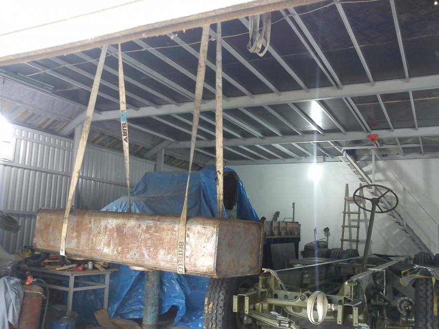

I haven't posted anything for a while but it didn't mean I had no progress.
Now it's time for some updates.
I spent a bunch of time making up the fuel tanks. Had 3 of them. Taking the worst one aside one was solid but filled with something like a bitum mixed with fuel and the other had rust inside wich followed some holes in the bottom.
Not bad at all. The first one was washed with about 200l of diesel wich I'll use in my house heating and the second one was filled with 3-4 handfulls of gravel stones, hooked up in two straps and wobbled by hands hell bunch of times.
Astrakhan.01.2013.00396.jpg   Vnukovo.04..2013..00395.jpg   Vnukovo..05.2013..00425.jpg   Vnukovo08.2013.00368.jpg
