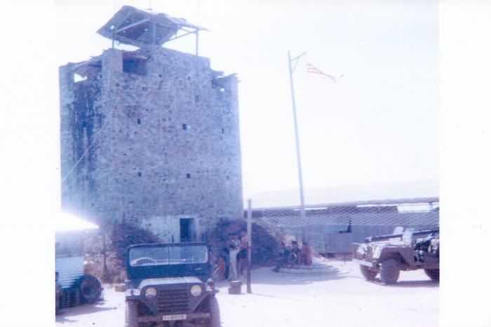

I am hoping someone can provide the background identity of the Australian Army Landrover 'gun buggy' photographed in South Vietnam. Most of the number plate (112 37X?) can be seen, as well as some unit ID plates.
The photo comes from a 35mm slide, and was taken by a sig. operator belonging to 104 Sig Sqn, between December 1968 and September 1969. It seems to have been taken at an ARVN post, judging by the SVN flag. I also recall his story that he was up a tower during an attack, and the sig. cables got entwined with a machine gun. This story and the pictures may not be related, but ...
He was sometimes sent in a team of one or two sigs, as a liaison sig with Aust and/or US and/or ARVN units.
I am hoping that someone might be able to ID the Landrover and the unit it belonged to. If that could be done, perhaps I could trace the unit's war diaries, in the hope of identifying a date and place of that operation.

The unit (RH) tac sign looks to be "60" - if that's correct, the unit would be 6 RAR. The smaller plate on the middle top of the grille, which appears to read "SA 4", would identify the vehicle as the fourth vehicle in the anti tank platoon of Support Company, ie S = Support Company and A = anti tank platoon.
On its second tour, 6 RAR served in SVN between May 69 and May 70 - so the timeframe fits.

I believe that is ARN 112-372 the vehicle still exists. It was one of very few that had what look like large tac sign holders on the sides of the front fenders. In fact I took the option on the purchase of a pair of buggies which included 112-372 plus 112-723 and I kept the other one because at the time we hadn't confirmed the SVN history of 112-372.
And 112-372 as it was when I inspected it.
The vehicles had been on a eco farm hence the faux indigenous art.
The vehicle is now under restoration in the hands of an enthusiast, perhaps it will go to Corowa in the near future.
Another shot in SVN with 4 RAR
As it was before disposal.
If people are interested, there is a thread tracking the buggies and whether they are known existant. http://remlr.com/forum/index.php?topic=9.15

The Gunbuggy in the photo could be one of nine vehicles that had the ARN 112-37X.
The nine are:
112-371
112-372
112-373
112-374
112-375
112-376
112-377
112-378
112-379
The suggestion that the Gunbuggy in your photo is 112-372 is unlikely as it has too many differences to the photo below showing 112-372 in SVN. To add to this, a close look at the ARN plate on the Gunbuggy in the photo you posted shows a looped bottom section to the last number. This would exclude the number 2 as it has a flat base with no curves.
In the photo above, 112-372 has:
1. Bonnet mounted strap tie down saddles (none on yours)
2. Higher mounted ARN plate (yours mounted lower)
3. White paint to bumper ends (yours has no white)
4. No bridge weight plate (one mounted on yours)
5. Drivers mirror is rectangle (yours has a round mirror)
6. Has no rectangle shaped red vehicle ID plate to grill (yours has plate)
Other Gunguggies in the 112-37X series also had the larger guard side panel TAC plate holders. From photographic evidence we know that 112-373 and 112-375 had the same larger holders.
My bet is that it is either 112-373, 112-375, 112-376, 112-378 or 112-379
