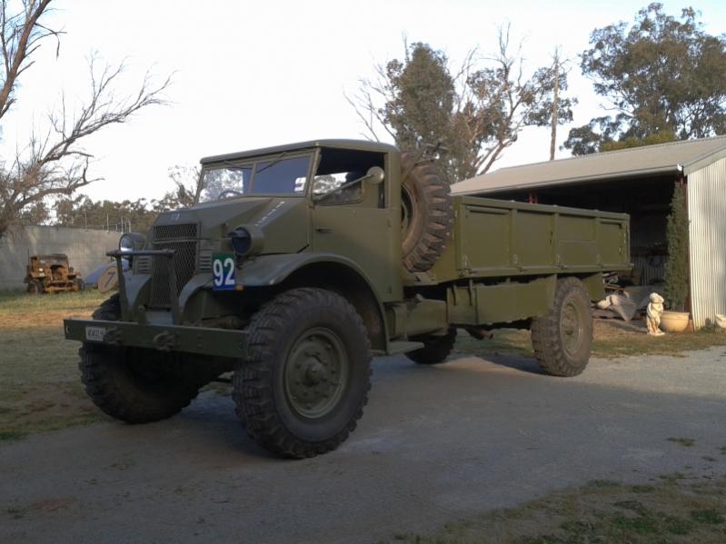

Default Now this is fun
Have finally managed to find some sides, get them repaired by Andy Fulton and have started the process of fitting them to the truck.
Again I have been given some invaluable help from John Mackie.
Thanks H for the lend of the trailer and Bruce for the pallets. These projects dont get done without help from everyone.

Well done mate she looks bloody great. It makes all the hard work worth while when you get to this stage i bet.

Phil, the cab does get very hot - good with the windscreen up but being such a heavy thing (the windscreen) it is hard on the supports which hold it in place. I can see why the 13 went to the split windscreen.
The truck seems to be very tolerant of warm temps to a point.... anything under about 30 degrees celsius (outside air temp)... after that, it gets bloody hot. How does the Chevy go?
I may have stumbled across some very good stuff to put on the engine covers - more on that when I get to it (could be a few months).
Alex, with regard to tailgate, watch this space...
Bob, apologies about the photo's. They are taken with my mobile phone so they are a crappy quality to begin with.
Question.... Does anyone have any photos of the drop side hinge in front of the wheel arch box - would like to know if it is welded to the box or the tray? It is in a cow of a position...
What the heck, lets have another look

I think you're right Robert, but the telltale marks and bolt holes may indicate another use.
I'm not sure, but it may have been a fold down bench seat the length of the side.
People may be wondering why this truck has full steel body?
This body was fitted to this truck in 1944 as its original configuration was as a 2 pounder anti tank portee.
In answer to your question earlier Alex - tail gate has been obtained from Ashley Wilson at Yass and repaired by Andy Fulton. Many thanks to both of you lads.
Photo's also show that Clevo seems to find his new Kennel quite acceptable.

After much stuffing around....Ta Dah!!!
New sides 15.jpg   new sides 02.jpg   Sides 05.jpg   New sides 12.jpg   New sides 13.jpg

???? on the pass. side under the floor.... above runing board... is that the rad. expension tank for the cab 12...?

Thats right Bob, shortened fuel tank basically. Not hooked up at the moment had a lot of crap inside the tank free itself up over a couple of years.
It finally let me know it blocked the line when it spewed coolant all over the front of the motor and conked out going up a hill.
No damage done but considerable anxiety caused at the time.

If I am not mistaken those tanks have soldered ends..... you might be able to take one end apart, cleanup the inside.... and resolder. Or a rad shop could do it for you.....
I would be tempted to sit the tank on its side in a large pan with one inch of cold water and apply heat to the upper side....water should keep the heat from loosening the other end. A coating of fuel tank sealer paint on the inside when reassembled would seal any pin holes..
