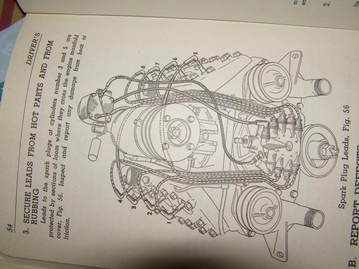

Here are two photos from manuals, the drawing shows the HT leads on a Canadian Mk1, the photo is the British Carrier, with Lucas coil and Ign Filter unit, blocking where the hole in the tube would be and HT lead for No.5 coming straight up from the dizzy.
Old 23-06-13, 16:47
Alistair, I haven't been through this yet, either. So this is a guess
The British dizzy allows for the leads to cross at the cap.
The crab dizzy doesn't, and so leads 3 and 5 must cross over on top of the motor.
There are different conduits for the different dizzys, and each has its left and right. So no 5 lead comes from the other side tube (on the inside)etc. See Robert's first picture.

The manual shots with the Crab distributor give all the detail that I require! I never thought to compare the crab distributor HT connections with the firing order. Now I know the RF interference reduction capacitor unit is for the original Ford coil on distributor (divers helmet) arrangement and if I want to fit a UK spec canister coil I need the other radio filter type. Can anyone help me out with that?

Old 01-08-13, 08:06
Adding more images to help.
The first image shows the two "cross over the motor" H.T. leads at the front (artist's priority was a pretty drawing) Lead no's "2" and "5" have to cross (the top of the motor)from one side to the other with the Crab distributor.
Image two is the firing order and cylinder lay out from a British Ford head casting.
The last image shows the neater wiring layout of the early (football, divers helmet) distributor. (note the info on which is left and right, and how it is arrived at)
