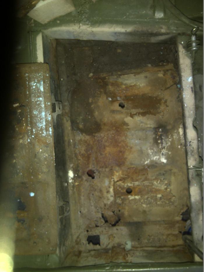

Default Battery box chronology, sped up for TV
The titles of the jpegs are the stages. The shots are all at the discovery and destruction stages.
The inner battery box bottom has a big diagonal repair through it from the re-militarization. The outer battery box bottom is half eaten away by rust. This is where the safety inspection poked into rubber matting.
The tray itself is loose, and in really good condition. However, it has 2 dimples to drain the expected spilled battery acid. These dimples get in the way of any repair panel I was prepared to build in a week's time with my limited welding skills.
M151A2 battery box as found resize.jpg   M151A2 battery box 2 resize.jpg   M151A2 battery box 3 resize.jpg   M151A2 battery box 4 resize.jpg

Default Battery box chronology, sped up for TV (second episode)
So the first sequence took the loyal MLU viewer from discovery to 'now what have I gotten myself into?'.
The next sequence doesn't quite capture the thought processes. Should I replicate the good battery box? Could I make origami with sheet metal? What gauge of steel, the 22 gauge panel I bought or the salvaged pieces of 12-ish gauge from some long-forgotten trailer?
In the end I decided I had neither the time or inclination to make a fancy cake pan-like piece. Time was pressing to get the vehicle back in for inspection before the long weekend. Make it flat. Make it simple.
I convinced my brother to come over and weld for me. The heavy gauge steel was free and strong enough to support the batteries without reinforcements. The resulting welding had a fair amount of spatter, but there are no voids of pinholes. The bumps and zigzags were ground off, and looked nice and shiney.
I painted the fresh ground metal with Rust Killer spray paint. Which is not Rustoleam spray paint. The outer layer on the bottom is asphalt rustproofing spray.
The inner battery box depression, the intact one, is now concealed under a loose piece of heavy gauge steel.
M151A2 battery box 5 resize.jpg   M151A2 battery box 6 resize.jpg   M151A2 battery box 7 resize.jpg   M151A2 battery box 8 resize.jpg

-filled several specious holes in the dash
-repaired the battery box floor
-new build battery hold down - significantly safer and smarter than 2 bungee cords and some J-hooks
-sealed the gas tank and banged the flange flat-ish
-replaced several parts of both front floors
-replaced left and right body sides - poorly rewelded when reassembled
-replaced left and right rear wheel well tops and the 45-deg brace
-replaced all cross members and hidden supports across the back wall
AND
-installed NOS underbody reinforcement hat channel kit
-the engine starts and runs with fuel out of the tank.
-pressure is 31 - 32 PSI at idle.
-voltmeter is charging and shows in the green.
-the roll cage is sitting in the right place, just needs the application of some English to sink into the six sockets. Exterior bolt holes line up.
-probably 18 or 20 spray cans of Krylon camouflage olive green so far - word to the wise. US and Canadian Krylon formulations are not a match. The primer is a high specification two-part paint/surface sealer that came (legally) out of the fabrication shop's paint locker. Leftover from a client's contract and not ordered destroyed.
-rubberized undercoating on underside.
The reassembly continues, and yes I am anxious to drive!
