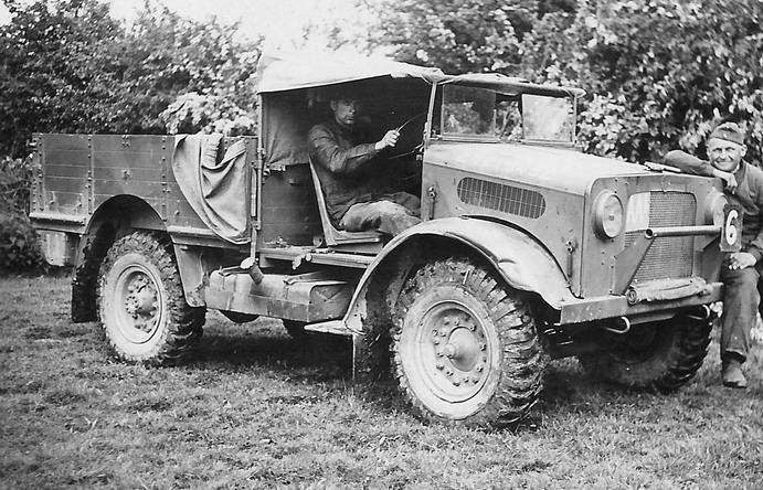

The 6 AoS on blue-red is the early Anti-Tank Royal Artillery so perhaps she towed a 2 Pdr or a Bofors Anti-Tang gun?
The air vents on the Pattern 11 cab is odd, what was the transition date to Pattern 12?
Here is a similar early AoS from France 1940.
-Bob

I'm not confident about making that AoS match. The Indian Army had its own system, or was following British lines but with idiosyncrasies, so a "6" might mean something totally different. It's a possibility though.
Aris

If you look closely at the CMP AoS sign you can see the two tones split horizontal which should be blue.red with a white 6. This was the early war A0S for Anti-Tank units. Indian markings I'm not sure about, they may have the same or perhaps it isn't Indian?
If you like the Bedford, here is a side view of the same. I'd love to be the Jerry who stumbled across such a nice example of the MW.
-Bob
