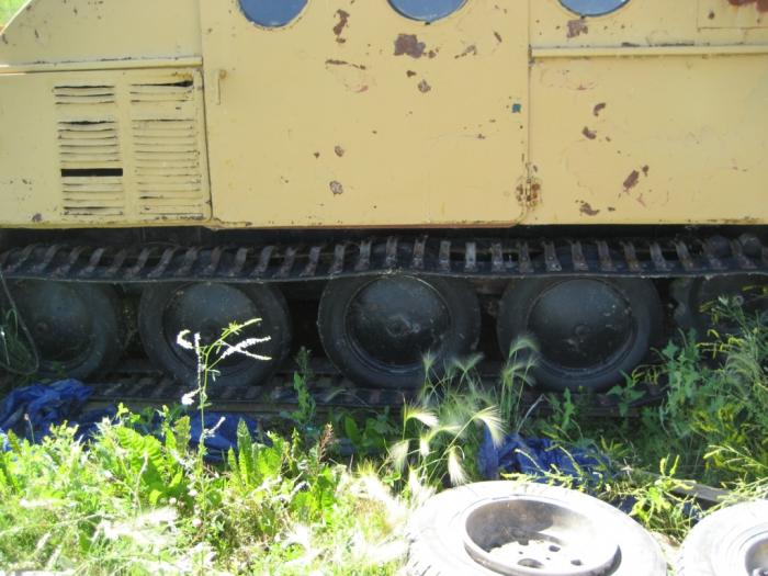

I finally got around to hauling the Penguin Mk3 home last Sunday.
I had spoken for it a few years ago, and had agreed to a trade deal, but was reluctant to pick it up before completing work on one of the trade items. On May 31, the previous owner came and picked up a Lincoln Zephyr V12 that was part of the deal, and I was going to get the Penguin, fittingly, on Canada Day. It was a little too soggy then, so a recovery mission was mounted last Sunday.
It is a Mk3. serial #77, dated 1949. Not running, but with new track belts. Has a SK licence still attached from 1968. Previous owner got it from a ranch on the edge of the Cypress Hills.
I would really like to get a copy of the parts book, or any other manuals that might be out there.
