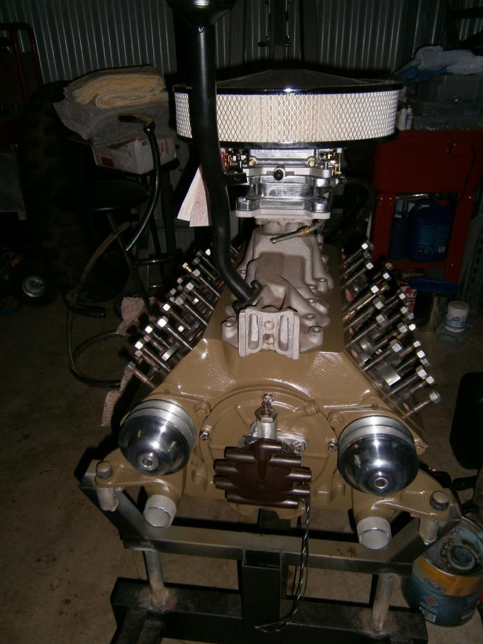

  #1147

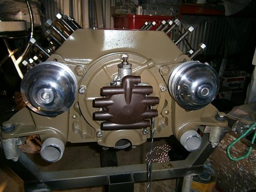

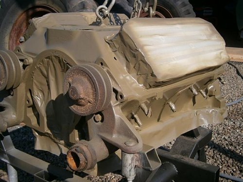

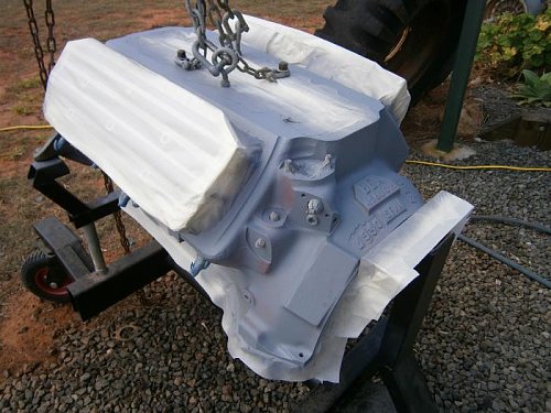

Old 01-09-13, 11:59
Default Engine Painted!
Sanded and painted the engine block today.
Name:	Engine primed 1.jpg
ID:	59949 Click image for larger version
Name:	Engine painted 1.jpg
Then I installed the water pumps permanantly, and test fit the timing cover.
Name:	Water pumps installed 1.jpg

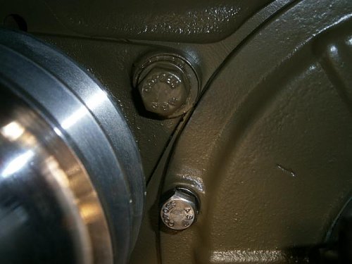

I had to shave a slither of the thickness from two places on the timing cover. The new water pumps are a tiny bit thicker around the bolt holes, and it was easier to shave the timing cover, instead of trying to unstick the water pumps. I had used aviation gasket sealer on them. I'm sure the gaskets would have come away in pieces!
Name:	Water pump and timing cover clearance.jpg
Robert, this photo is for you.
Name:	Engine with external parts test fit 1.jpg

Very impressive you'll have the first blitz to spin the wheels in all gears

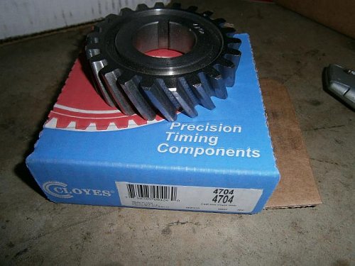

Old 03-09-13, 16:11
Default Christmas in September

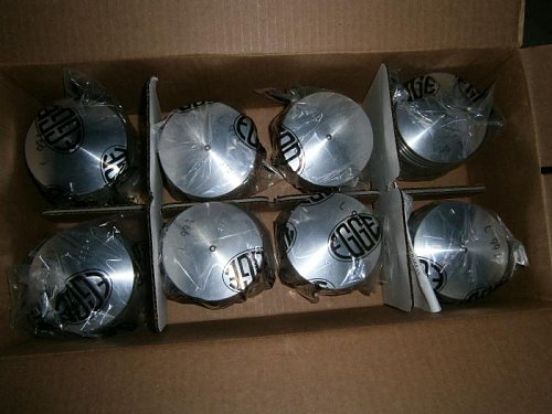

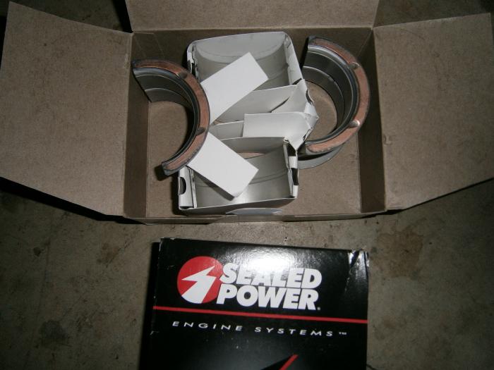

Santa has arrived early this year!
Name:	EGGE piston set, STD bore, 4 stroke.jpg
ID:	60042 Click image for larger version
Name:	Clevite Rod Bearing set.jpg
ID:	60043 Click image for larger version
Name:	New Main Bearing set.jpg
ID:	60044 Click image for larger version
Name:	New crankshaft gear.jpg
ID:	60045 Click image for larger version
Name:	GRANT 4 Ring piston ring set.jpg
Cont'd...

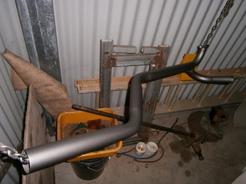

With the whole oil pan 'abortion' still fresh in my mind, I turned to my set of NOS exhaust pipes. At least, the part of the exhaust that comes from the manifolds. I have both pieces, and have been itching to get them cleaned up for a long time. The original coating of paint, light surface rust, welding slag (very small bit) & adheased part number ticket, posed no obstacle to the wire cup on the angle grinder. I was very pleased with how the metal cleaned up. Three coats of VHT Flame Proof grey later, I hung them in the shed to dry. The rear end of the exhaust pipe is 2". For some reason I thought it would have been smaller diameter than that. Is that size correct, of are these pipes off a civilian Ford vehicle?

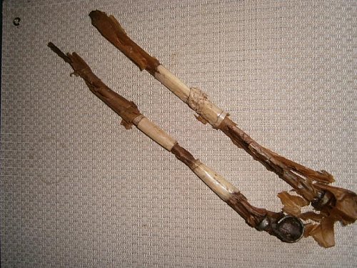

The NOS dipsticks I found at the Gympie Swap Meet on 14th.I only opened one. It cleaned up VERY well.

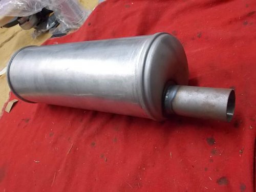

This is one of the exhaust pipes I was talking about. Is 2" tube the correct size for these trucks? I was considering making enquiries around town for a suitable (but not authentic!) round muffler, but will hold off doing so until I know the correct tube size.

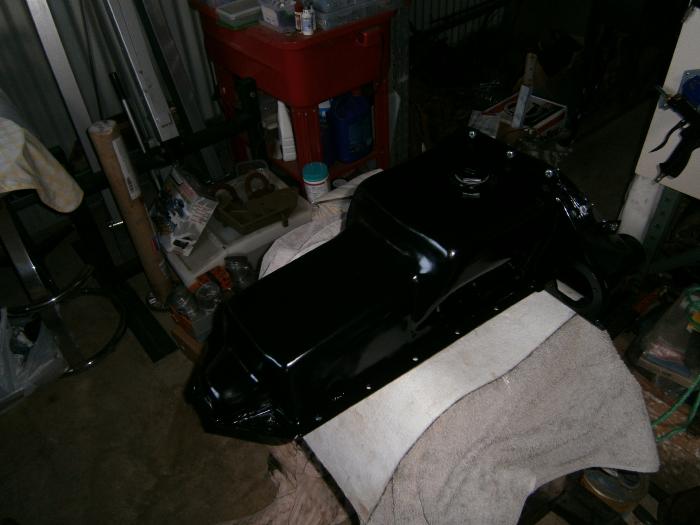

Name:	Oil pan painted.jpg
This bloody oil pan didn't arf give me jip! My own fault though. Never mix paint types on same part.

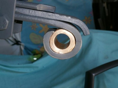

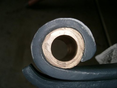

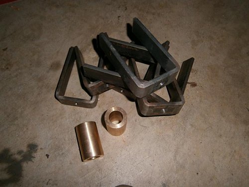

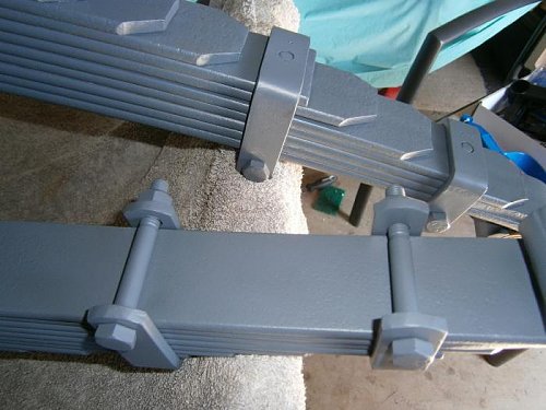

Default Front springs ready for painting tomorrow!
These spring clamps were made to replace the originals, which were damaged and mis-matched (two different types on same spring set!?!?). Is that original spec.? A local welding/fabricating shop did the folding for me. The bushes you see are for the front of main spring leaves. I don't know how, but I must have lost the original ones. I do know they were buggered, but would have been REALLY HELPFUL to give them to a lathe operator for duplication in original specifications. Guess they will turn up now that I don't need them any more.
Name:	New front spring clamps & spring bushes.jpg
Not a bad fit. All except one of the rivet shafts remained stuck firmly in their respective hole. The missing one was replaced by welding a very short piece of round rod to the clamp going in that location. I considered building up weld on all the clamps to replicate the rivet heads, but it would have taken me hours to whittle the blobs back to a round dome. I know, I tried it! I'm also too shakey to hold the grinder accurately. Maybe I could glue little wooden buttons on them.
I still need to remove the excess thread on the clamp bolts. Will do that in the morning, just before I 'string em up' for painting.
Name:	New front spring clamps installed.jpg
The spring 'eyes' at front were not round, so the new bushes had to be ground down to the right profile. I used a pedastal grinder with fine stone wheel. Once the bulk of the metal was removed, I finished off the last little bit of shaping with a hand file. I don't EVER want to do that job again. Painfully slow if you're as paranoid as I am about taking too much metal.
Name:	New front spring bushes installed.jpg
Despite being careful, the bushes were not a 100% perfect fit, which means the grease would have pumped out the sides instead of getting to the spring pins. That's bad! Sealed the bushes completely, using the pliable metal substitute that was used to rebuild the water necks of the engine heads. It's really good stuff, and I have no doubt that it will do the job. I have a sore thumb now, from forcing the stuff in between bush and spring eye. And Yes, I did remember to make the grease hole in both bushes. They even line up.
Name:	New front spring bushes, sealed.jpg

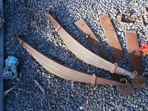

This is how the front springs used to look.
Name:	Front springs 1.jpg

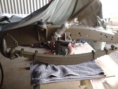

  #1159

Tony since the grease is fed from the pin to the bush the spring eye will only get the excess, well that how I see it.
macca C15 C15A
  #1160
Old 22-09-13, 13:30
Posts: 167

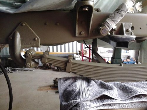

Default Spring Clamps

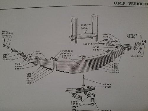

Hi Tony,
It's pleasing to see you back continuing your interesting thread again.
The front springs have two different style clamps.
Bolted ones on the front half and fold-over ones on the rear half.
It's to do with having less clearance between the spring and chassis at the back I would think.
After being rivetted to their respective spring leaves the folded ones are manouvered over the main leaf then the intermediate leaves are slid in between (with a bit of hammering), then the centre bolt and the front clamp bolts fitted.
On my truck I ground all the rust from the mating spring leaf surfaces, primed them, then gave a coat of Molybdenum di sulphide grease to get a nice smooth spring action.
Some say that this can cause broken leaves but I have never seen that happen.
Kind regards,
Terry.

Hello Bob,
Not how these springs are set up. The main leaf end has a threaded hole for a grease nipple (or is it a 'zerk'). The grease passes through bush and to the pin via a machined inner channel running around the ID of the bush. If not sealed, the grease would take path of least resistance and squish out the gap between bush and spring eye.
Having said all that, the pivoting rear pins of each spring ARE the type that have lubing via the way you described! I bloody well wish the fronts were too, to be quite frank. I think it's a much better idea. Some day i'll come across a couple of new pins like the rear type, and will make that change to the front.
I got the front springs painted this morning. Did the rear pin retainers and nuts at the same time. The U bolts have been cleaned this afternoon and undercoated. I am still to do the set of plates that attach the axle to the springs. Those should get blasted. They are not in bad shape, but there's no other way for me to clean out the recesses. I'll do that blasting at home. I would have had those finished today too, except I had to make an unscheduled stop to all work, to try and protect my 'new' little car from an approaching hail storm. Quickly lined the roof, bonnet (hood) and rear hatch with some carpet remnants, then put a car cover over it all to keep everything in place! This car was bought new by my Brother, 5 years ago. It has now been given to me. It's such a tiny thing and only had 19,750km on the odometer when I got it the other day. Now has 21,000km on it. Most of that has been in trips to/from Mothers place, just north of Brisbane. Not one scratch or paint chip on it anywhere, with exception of the wheel trims. The last thing I wanna see is hail damage on it. I need to build an extention to our undercover car storage, to preserve its great condition.
Won an auction for a set of 3 genuine Ford battery caps. The type for the correct battery that Ford would have used in the early to mid 40s. Hopefully I will have some exciting news to tell on the topic of batteries, in a couple of days time.
  #1162
Old 22-09-13, 13:41
Oh God, Terry! Don't tell me the springs may not fit, now that I have made all the clamps bolt on type! I guess I could get replacements made easy enough, but whole thing will need painting again.
I will have to do a test fit tomorrow afternoon, if I can.
Thanks for the info.
Pete Ashby once told me a Volvo 240-series exhaust muffler makes for a good replacement; the flathead keeps a throaty roar with one of these fitted.

Thanks for telling me about the Volvo muffler, Hanno.
I took another look at the Ford manual, and it shows front springs with bolt-on clamps all round. Anxiously looking forward to the test-fit this afternoon.
Tony,
1-3/4" seems to be the standard, reportedly bigger diameter pipe makes it lose the "old flathead" sound. If you want I can measure up my truck's exhaust pipe tomorrow.
Your engine pipe looks correct to me Tony. All my Fords have 2" engine pipes. Two of them have what appear to be original mufflers (dished end plates, 6" diameter, 18" length) and both of these have 1 5/8" tailpipes. This is consistent with several original tailpipe brackets examined by Jacques and me recently. We determined that they're designed for 1 5/8" pipe. They will accept 1 3/4" pipe, but will not fully close when tightened.
I notice Macs Auto have a suitable muffler for about $58, however it's probably not worth the inconvenience.

Thanks very much, Tony!
All this information from you fellows is valuable and greatly helps me to make the right decisions.
ID:	60592 Click image for larger version

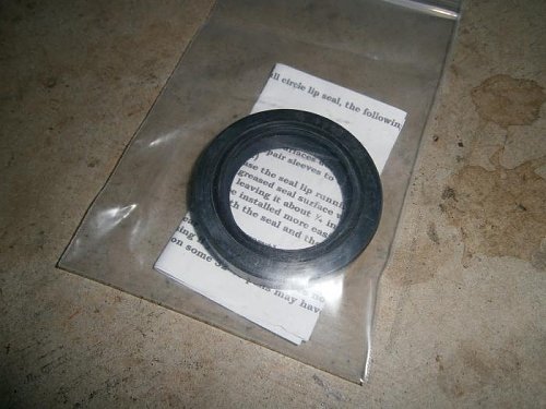

I had once investigated ordering one of these from USA, but cost of shipping was incredible. From memory, muffler was less than $90, shipping was more than $200! Bugger that.
It was a genuine Ford product too.
I downloaded these 3 photos at time of first contact with the vendor, but have lost where their I wrote down their web address. Can't order one now, even if I wanted to pay the roughly $300 it would have cost me!

Default Ford front spring clamp clearance
Yeeeeeees!
ID:	60595 Click image for larger version
The test fitting of one front spring set has shown the new clamps clear everything very nicely. Under very heavy loading or lots of side to side torsion, that may be a different story, but it would have to be fairly extreme flexion to be a problem.

Tony,
Just took a picture and some measurements. The diameter of the front pipes connecting to the exhaust manifolds are 1.5", the rear pipe after they merge is indeed 2" diameter like "theotherTony" stated. My bad.
Hope this helps,
