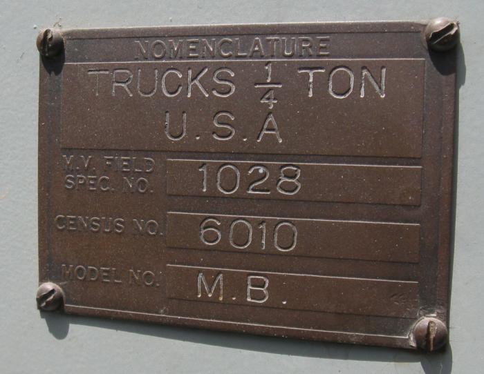

  #161
Old 29-10-13, 11:35
Posts: 606
Default for the Jeep guy
Ian, have some pics of the data plates & dash.
It is owned by a local Jeep collector.
I do not know anymore details of its authenticity or history.
But is a nice tidy slat Jeep.
1943 MBT trailer
1943 Dodge WC-57 Command Car
Under restoration:
1940 LP1 Bren Gun Carrier
194? 1 Ton Trl Ben Hur
1942 C15A with sunshine cabin
MVPA 31338
  #162
Old 29-10-13, 15:17
Interesting. My MB 135668 is May production. This one is 11000 earlier, with a later production date.
  #163
Old 29-10-13, 21:56
Build date is 6th March 1942
Remember USA write their dates Month-Day-Year
  #164
Old 29-10-13, 23:09
Of course Richard. What was I thinking?
  #165
Old 01-11-13, 01:24
Jeep guy in CMP world!
Location: Sydney, Australia.
Posts: 340
Hi Darrin,
Thanks for that. Well the ARN matches the serial on the plate, so i guess they just wanted to paint it RAN- which, like your follow me, makes for a nice change! I wil have to keep an eye out for it at Corowa if it makes it along and try to have a chat to the owner! and your quite right, it is a very tidy looking slat grill MB (with the neatest stamped MV field spec/nomenclature/census plate ive ever seen!)
Ian.
Ian Fawbert
1944 Ford GPW
1943 #3 GMH jeep trailer
www.vintageengines.net
  #166
