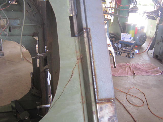

The top of the dash was fairly well gone so I decided to remove it all and make a complete new part.
M52A1X4 001.JPG   M52A1X4 002.JPG   M52A1X4 003.JPG   M52A1X4 004.JPG   M52A1X4 005.JPG
Old 16-11-13, 08:55
colin jones's Avatar
Posts: 1,810
I also had to replace a top section of the pillar that holds the windscreen on. That was really bad
M52A1X4 006.JPG   M52A1X4 007.JPG   M52A1X4 008.JPG   M52A1X4 009.JPG   M52A1X4 010.JPG

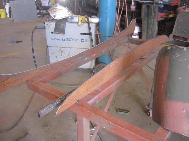

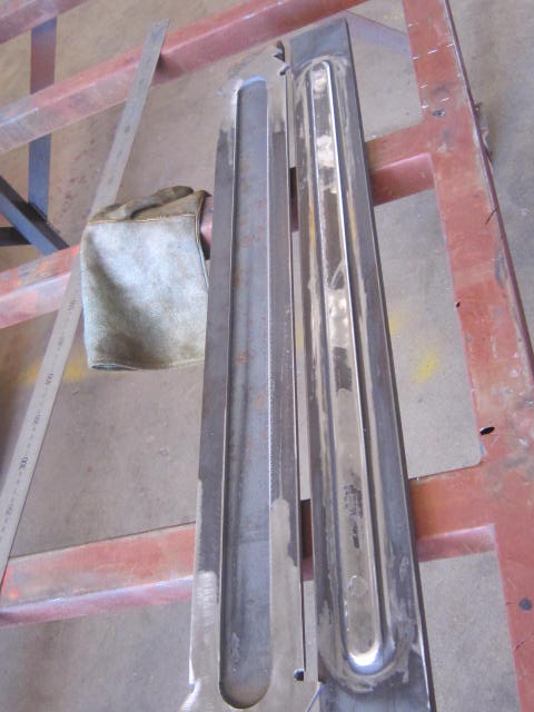

Old 19-11-13, 04:49
Posts: 1,810
The back is a bit too far gone for a patch up, so again I've made a very crude and unattractive pair of press die's!
M52A1x6 001.JPG   M52A1x6 002.JPG   M52A1x6 003.JPG   M52A1x6 004.JPG   M52A1x6 005.JPG
Old 19-11-13, 04:52
Posts: 1,810
Of course if the panel never had the pressings then I would have repaired it and the rusted area is right on the press
M52A1x6 006.JPG   M52A1x6 007.JPG   M52A1x6 008.JPG   M52A1x6 009.JPG   M52A1x6 010.JPG
Old 19-11-13, 04:55
Posts: 1,810
Rather than make another set which I probably won't use again, I cut the first one down and welded it back at the correct shorter length I needed.
It has stretched a bit here and there but I think I can fix that problem.
Colin.
M52A1x6 011.JPG   M52A1x6 012.JPG   M52A1x6 013.JPG   M52A1x6 014.JPG   M52A1x6 015.JPG
