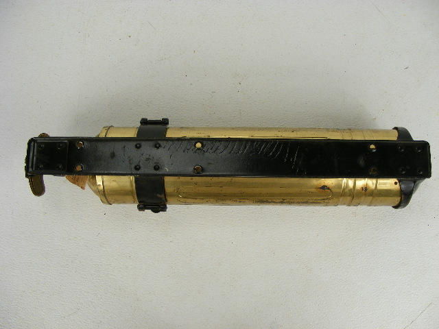

Default Fire extinguisher and roof hatch pad
Hi
Here is another set of questions.
Does any one know if it is correct that the fire extinguisher was placed to the right of the driver, beneath the sidewindow ? on a Cab 12 GT
There are six holes in the side placed in pairs at an angle.
The placement and distance between these holes corresponds well to the size of a Pyrene extinguisher, The problem is that on all the british vehicles I have seen/worked on the bracket for a Pyrene have 5 mounting holes.
Did the Canadians use a different bracket than the british? and if so how does it look and where do I find one?
Second question
In wartime pictures it looks like there was a pad on the inside of the roof, does any one have any dimensions or pictures of this and know how it was attached? there are no visible holes in the hatch of mine for a pad.
Niels; I just checked Servicepub's Factory photos CD and it shows a pic of a cab 11 CGT interior. The Pyrene extinguisher is indeed located on the inside of the body side panel, next to the right leg of the driver......at an angle as per the hole orientation. It seems both Chev and Ford carried these in the same location (holes maybe pre-drilled by body manufacturer?)
Regarding the number of holes....My C8 also has 6 holes in the rear cab wall and I came to the same conclusion as you did. Both extinguisher brackets I bought online have 5 holes.....My conclusion is that it might have to do with the release mechanism.....my examples have the spring loaded thingy holding the top, but I have also seen them with an extra band/quick release thingy about 2/3 thirds along the extinguisher. Maybe that's the type using 6 mounting holes????

Default fire extinguisers
Hi Alex
Thanks for confriming that
I as well have both sping loaded, with band 2/3 up and a with clamp that goes over the pump handle, and these are all 5 hole versions.
From looking on google it seems that US vehicles had different types of 6 hole brackets.
I wonder which type is the moste correct for a CMP?

Posts: 3,720
Niels.
Either style of bracket is perfectly acceptable for your CMP. The key is the cup shaped base that holds the nozzle end of the extinguisher. There are even more varitations in the brass extinguisher. This cup disappeared in post war brackets that were either flat folded sheet steel with a spring clip, or a bent wire rod style bracket with a spring clip.
These extinguishers in themselves could fill ones living room if you wanted to make a collection out of them!
Have fun with your CGT!

Niels,
I was just looking in the parts list this morning and found under extinguisher, that all types (C8, C15 etc. CGT) use 6 round head slotted screws for fastening. So, I guess you (and I) have to look for a different bracket.....or as David says....just go for the 5 hole version .....and maybe drill two extra holes in the bracket.

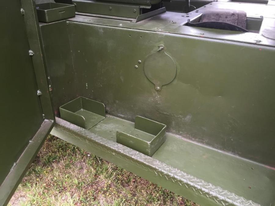

Default and by the way
Here is my Second CGT that I bought last year, also from Norway, it took about 15 min for me to decided to buy it, even though it was some 2500km from where I live and 350 km north of the arctic circle, but it turned out that the shipping to Denmark was actually pretty cheap.
It was restored from bad condition back in the late eighties, by three young guys, using what they could find of original parts and the rest they made.
They restored it to their best effort but in the time before internet and MLU forum, they didn't have access to the same amount of reference material and parts as now, so I have adding/replacing parts on it, and are still missing some things, slowly but surely its getting there, I hope to be adding the roof vent hatch's and spare wheel clamp later this summer.
and then at some point a repaint..... its a bit to frog green for my taste.

and here are some more. The floor is modern alu dock plate, which I would like to replace at some point, but I need the driver and passenger foot well pieces, if anybody has some to spare.

That's a lovely truck, Niels!
It seems the frames for the roof vents are still there on the inside of the body (?). I am afraid I can't help you with floor plates in original pattern; although I think the alu ones shouldn't look too bad for the time being, if you put some paint on them.

Hi Alex
Thanks. no its just the cab frame you can see. The roof hatches is attached via an angle iron frame on the outside.
Yes the floor needs painting, and I need to fit the winch handbrake.
I am thinking about repainting it SCC 15 Olive drab, since it was rebuild in 44, but would still like a bit of wavy black on it, but I am not entirely sure that's correct.
An interesting thing about it is that in some places has Ford parts e.g. the rear winch guide and drive for the winch
