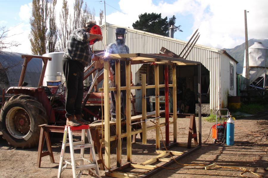

Posts: 201
Progress has been slow lately, but we try to do something to the truck almost every week to keep the momentum going. Recently we have been measuring and cutting out the bearers and cross beams for the tray and welding them together. We were lucky that Greg (tartan shirt) happened to come along today and give us a hand as he is a professional welder and his welds put ours to shame. He spent some time today grinding some of our welds out and re-welding them.

Posts: 201
Today we continued welding the bed framework and getting everything square, true and straight before starting to attach the vertical supports and the three top rails. It was quite tricky work and reminded us again of the old saying: "Measure twice and cut once" We were lucky to again have the help of our mate Greg (black singlet) whose skill and experience made everything happen so much more smoothly.

Posts: 201
We continued welding the rear ammo body last weekend. Its quite time-consuming to weld all the joins and there are more to do yet before we can start installing the sheet-metal for the sides and floor. Slow but steady wins the race

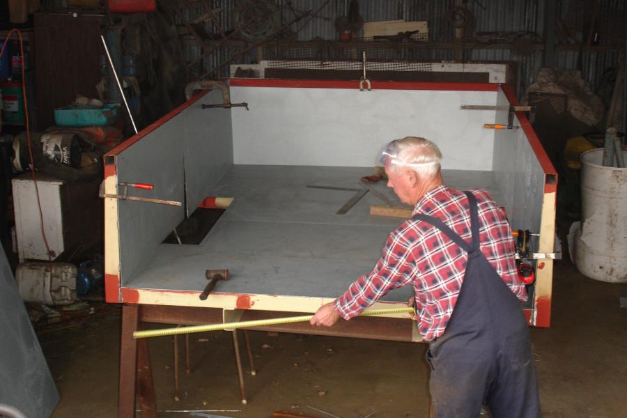

Posts: 201
Yesterday we started cutting out the 2mm sheets for the floor and sides and seeing how they fit onto the framework of the rear Godfreidson ammo body. None of the sheets are welded on yet, they are just clamped to make sure they fit properly. We won't weld them on until we are sure they are right, but it still gave us a boost to see it all coming together, just as Mr Godfreidson intended it.
