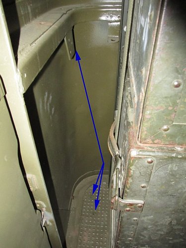

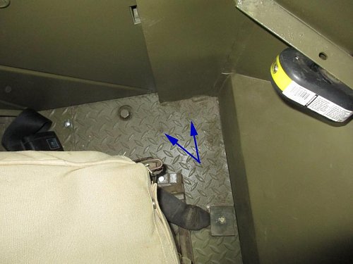

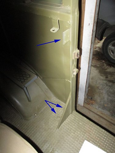

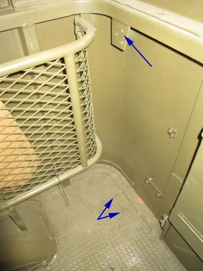

Default Photos of Rifle Cup Locations
Hi Maurice
First I check my HUP against my Pattern 13 C60S while the two mounting locations for each is 3 inches center to center. The HUP uses 1/4x20 captive nuts welded under the floor while the C60S uses 5/16x? threaded directly into the 1/4 thick floor plate.
Drivers Seat
Name:	1 Right Driver  Rifle Clip & But Holder CMP.jpg
ID:	63233 Click image for larger version
Name:	2 Right Driver Rifle Clip & But Holder CMP.jpg
ID:	63234 Click image for larger version
Name:	3 Right Driver  Rifle Clip & But Holder CMP.jpg
Front Passenger/Co-driver
Name:	1 Left  Front Rifle Clip & But Holder CMP.jpg
ID:	63236 Click image for larger version
Name:	2 Left Front Rifle Clip & But Holder CMP.jpg

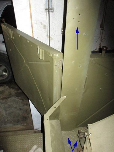

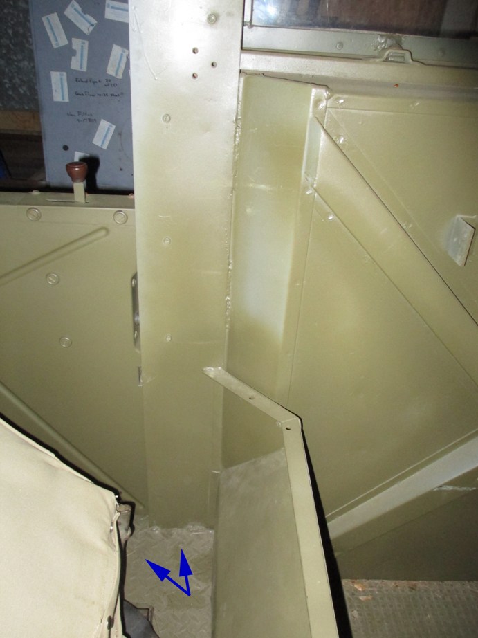

Old 03-02-14, 19:34
Default Middle Seat Locations
Middle Seat Left Side
Name:	1 Left Mid Rifle Clip & But Holder CMP.jpg
ID:	63238 Click image for larger version
Name:	2 Left Mid  Rifle Clip & But Holder CMP.jpg
ID:	63239 Click image for larger version
Name:	3 Left Mid  Rifle Clip & But Holder CMP.jpg
I assume that the earlier HUPs with mid doors on both sides that the right side mount would be the mirror of the left.
Middle Seat Right Side On HUP with no right mid door having the spare tire carrier in that location instead.
Name:	1 Right Mid  Rifle Clip & But Holder CMP.jpg

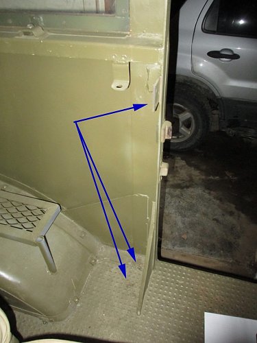

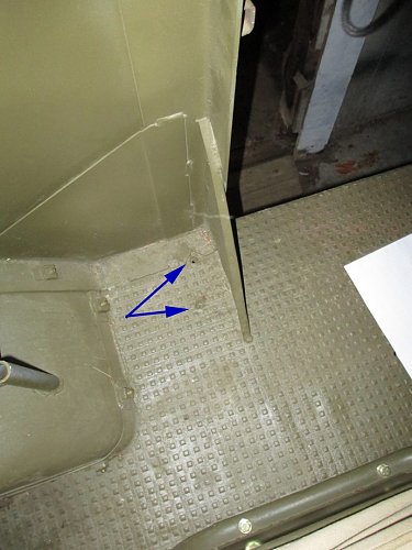

Old 03-02-14, 19:42
Default Rear Rifle Cup Locations
Right Rear Rifle Cup Mounting Holes
Name:	1 Right Rear  Rifle Clip & But Holder CMP.jpg
Left Rear Rifle Cup Mounting Holes
Name:	1 Left Rear  Rifle Clip & But Holder CMP.jpg
Does this provide the information you needed? I can post larger higher resolution versions of these photos if they would help or give you basic dimensions to locate the holes.

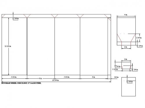

Next bit will be the 1 gallon can holders for under the rear of the body , when these are done the body can go on the finished chassis . Are there drawings available from these holders?I have seen copies in the past in France.

Default Is this the holder?
Hi Maurice
Name:  W Rear Holder Box.jpg
Are these the critters? I replaced the original holder boxes on mine because they had been flattened and straightened out to many times. So I have the originals sitting on the shelf, I think I did CAD drawings of them I'll look. Failing that I'll just measure and photograph mine for you to work from.

Default Pow can holders - hup
I used these diagrams to make up 10 sets of these beasts.
I welded up a set of them for my 45 HUP, so I still have eight spares (unwelded) here at the Hammond Barn, just south of the glaciers pushing from the north and just east of the frozen Great Lakes, in Canada.

Old 08-03-14, 00:28
Default As with many CMP parts there are variations
Hi Richard
As with many CMP parts there are variations, and differences in how they were made. I suspect that a lot of these small assemblies were given to small subcontractors and how they were made was best suited to what that contractor had equipment to do. They may even have been slightly modified to make use of left over steel stock trimmed from larger parts.
The result is your box and the one on my `45 HUP are slightly different in dimensions and method of assembly mine box is all formed from a single piece of steel. The computer just turned up my CAD drawing for the mine, Ok got a file format I can post to MLU.
Name:	HUP Wheel Choke Box V3.jpg
Will photo graph my boxes tomorrow.
You got to love MLU somebody needs info and within hours others are helping provide an answer.

Old 08-03-14, 03:20
Join Date: Feb 2004
Location: Beek Holland
Posts: 425
Default hup
great , thanks for all the info , I can see the remains from were they were welded on to the body , so have to go on from there .
It is also nice that everybody helps somebody else to keep the historical value upright for these vehicles with a certain character.
