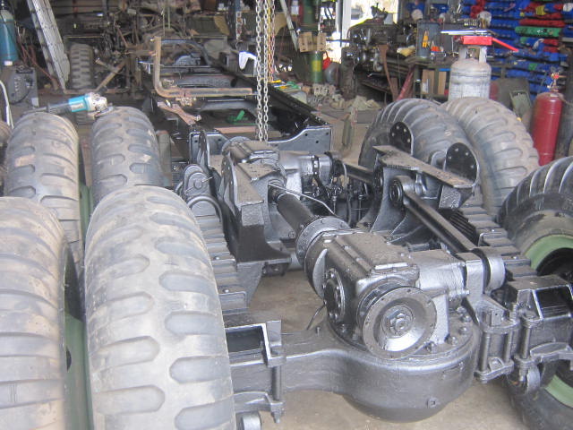

Hi all, sorry for the lack of pics. Our computer has been off and on for a while and we just found the culprit or I should say culprits. Bloody mice and/or rats in the roof chewing cables so it's time for a serious amount of bait to get rid of them.
Hi luke, I'm clad you like the purpose design dolly hammer. I've taken quite a few pics but I won't bore people with 20 pics from different angles. I'ts all been apart cleaned, repaired, painted and now it's going back together. I hope it will be finished in a week or two.
