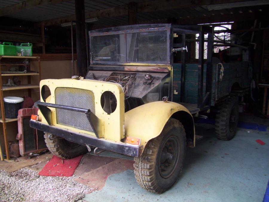

Well its been a while since I last posted on this forum I've been flirting with an Austin Champ resto project ,but thought you good folks on here might enjoy this tale of fun with this old Bedford Mw aeroscreen which I guess is a cousin of sorts to all those Chevy CMP's
This tale started over 18 months ago when I started my quest for an MW to restore and was lucky to find the old girl in a green house in the east midlands almost a year ago.
It turned out that its an early aero screen version dating from the start of the war this is a good thing as its a rarer model but does mean some parts have been / are hard to find.
Will add more pics of progress when I have more time.

Cab was originally an aero screen type but had a civilian closed in cab fitted when it was used for years in a zoo carrying animal feeds etc.
All rear body complete apart from inner wheel arches but timber shot and will need replacing.

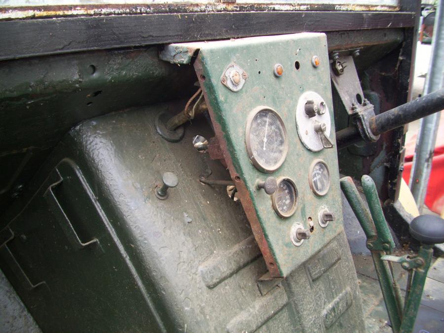

having a go at the gearbox. and ins panel

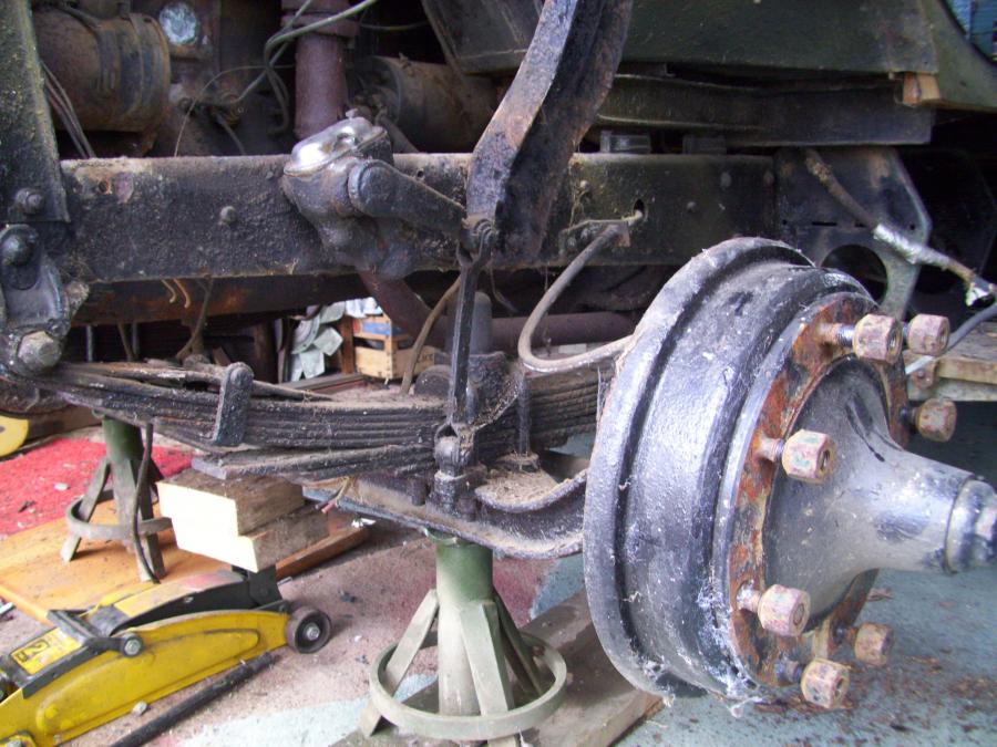

one major problem was the front springs were broken when I took them apart luckily Pete Gaine had a pair of good ones also had some nice xmas presents which inc an original air hose and gauge. the steering wheel is now refurbished and so are the headlamps.

Started to replace all the spring bushes and pins today a job I should have done whilst fettling the springs did manage to fit the radiator brckts and have a look at the rad.
