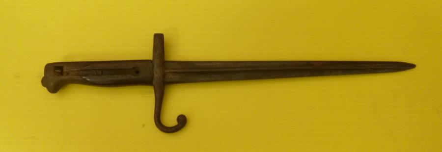

I was recently bequeathed a number of bayonets, khukuris and foils by an old friend but I am unable to identify two of the bayonets.

The first one is probably WWI vintage as the font of the marks look similar to other WWI bayonets I have. This one is longer being 16 3/16th inches (416mm) overall with a 11 inch blade (279mm). It has a large hooked quillon and has a spike type of blade with 4 sides. There is some machined flattening on the sides of the spike.( Different on each side.) The ricasso has some marks on the it. There are the letters SG on the lower side and unidentifiable crown or something on the upper. There are also an identifying mark E9?5 on the quillon.

The first one, with the cruciform blade is an Italian Vetterli Truppi Speciali M1870. It was used in the italian colonies.
