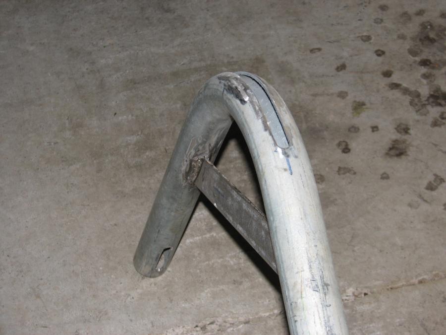

I am in the process of fabricating the gallows Bren gun mount for my M3A1 AOP Scout Car. I am hoping to get some measurements of the mount from another AOP owner but I have questions about how this mount on the AOP actually works.
I haven’t seen one of these mounts in the flesh and I am curious about how the Bren is fitted to it.
I’ve attached photographs of the gallows mount. I see it has some sort of cable arrangement on the mount with what appears to be a handle on the end of the cable. The bent part of the mount appears to have a cutaway in it so I presume the cable runs through the pipe part of the mount?
How is the cable attached to the Bren? I am familiar with the Bren but can’t see how the Bren is attached to this.
Can anyone enlighten me or send me some detailed photographs please?

I have a few of these mounts that are made into the sun shade frame on a modified Matilda dozer, I can take some close up photos if you like. the cable travels down the tube to a weight via a couple of pulleys.
Kind Regards
Old 13-08-14, 15:20
Join Date: Apr 2010
Posts: 1,068
There is a weight inside the vertical part of the tube. The cable is attached to this weight and comes out of the tube at the top of the bend and around a pulley. It runs across to another pulley on the end of the horizontal section of tube then down to a cradle which the gun sits in.
I have not seen a gun mounted so cannot tell you exactly how or where the cradle locates but from memory it consists of a bar with a 'U' shaped hook at each end as though the barrel of the gun could sit in it.

I think you can see the shadow cast by the cradle in the middle picture. It looks like two loops.

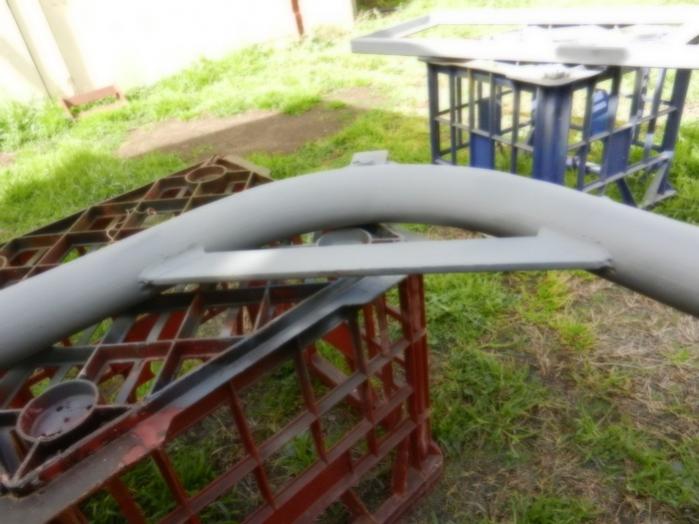

I have mine down at the sand blaster now and will pick it up later today. Happy to measure and get any details you need .
I will post some photos but maybe pvt e-mail for bigger more detailed photos if you want.
lets know .

first batch of photos of mine

next batch

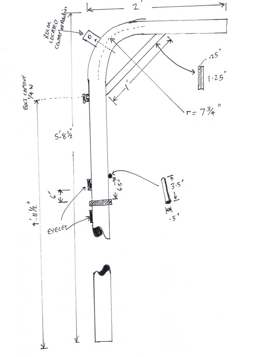

some dimensions for the lower half

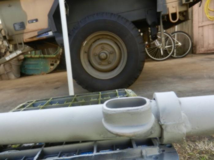

Front wheel detail .
The two eyelets located on the vertical part of the mount are castings welded on.
I cant draw them with any useful accuracy without doing a lot of work.
hope all that detail is useful

Wow, thanks everyone for all the replies, photos, and Gina, the plans. I wasn't expecting such a wide response. That's great and it all made total sense to me.
I now know what is required for this and I have a mate coming over tomorrow with some pipe. He has a pipe bender and so hope to make a start on it soon.
Thanks again.

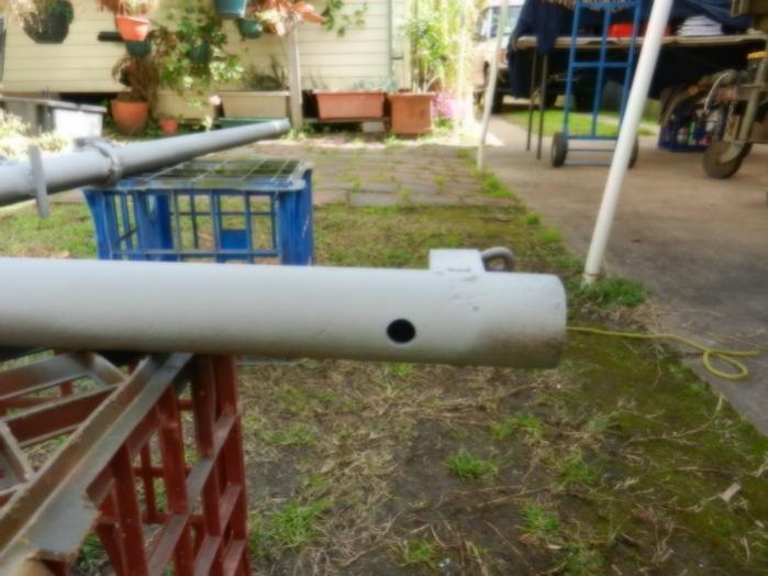

Hi all,
I have made some progress on this working off Gina's plan.
Gina (or anyone else who can assist); can you tell me please, what is the purpose of the captive bolt and the two eyelets on the pipe, shown on your plan? Do the eyelets just help to feed the cable through the centre of the pipe?
Excuse the ignorance. I am just trying to get my head around how it all works.
I have a couple of pulleys arranged so the mounts for these will be next.
IMG_9000 - Copy.jpg   IMG_9001 - Copy.jpg   IMG_9003 - Copy.jpg   IMG_9004 - Copy.jpg

Looking good Daryl ...sorry dont have a clue what the eyelets and captive bolt are for....

Thinking of getting one made as well, those drawings Gina will come in very handy.
