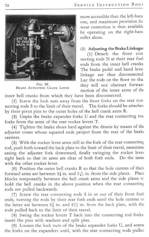

Using the adjuster gauges was helpful for me. Very helpful.
Steering, inner hole of bell cranks.jpg   Gauge blocks factory drawing.jpg   brake adjustment rules.jpg

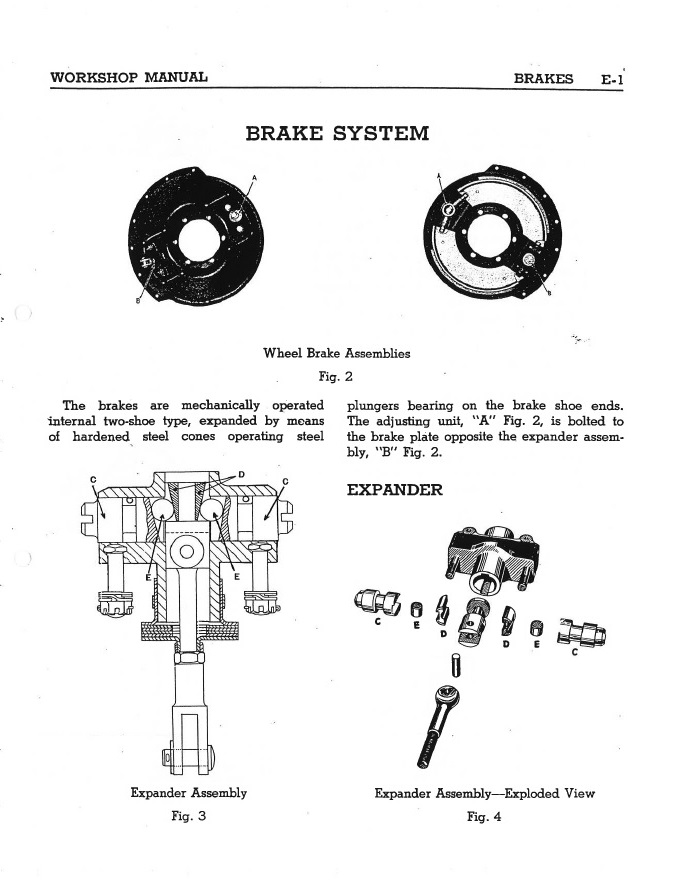

UC-F1 pages E1-E5

From OM-I ... courtesy Stephen C.
