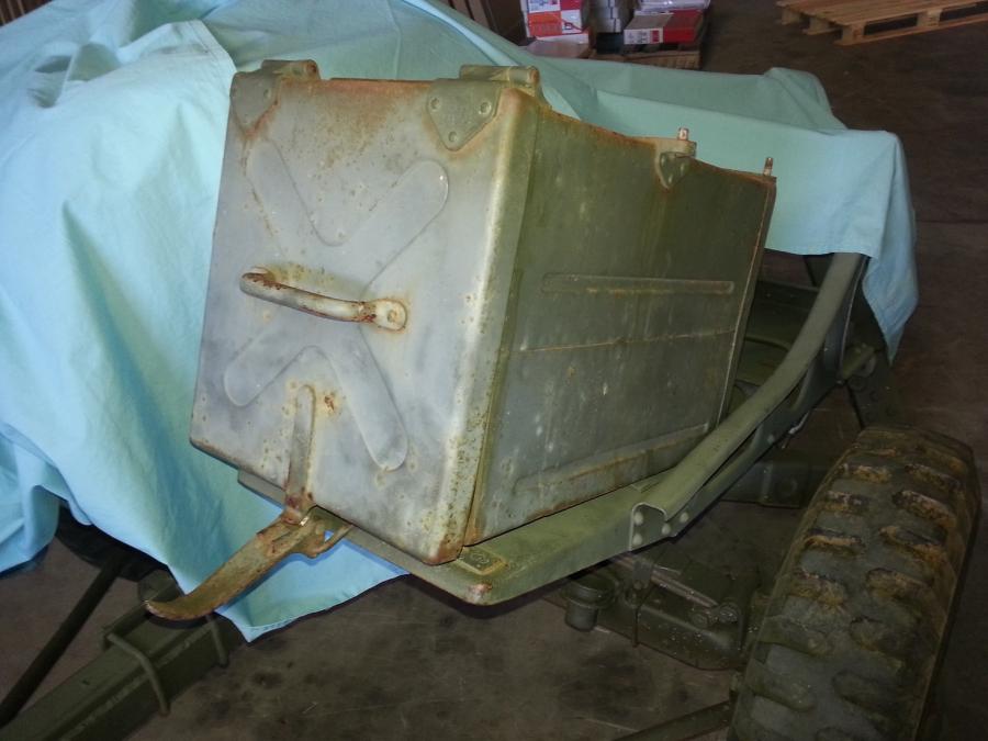

Also on another great note we have found a 2 pounder ammo box

  #205
Old 16-10-14, 13:43
aj.lec's Avatar
aj.lec aj.lec is offline
Andrew
Join Date: Apr 2007
Location: N.S.W AUSTRALIA
Posts: 1,623
Does anyone know how you can tell the difference between a Cab 11 and Cab 12?
You have a cab 12
Cab 11 have a bolt down flat plate for a bonnet and a full 1 piece grille and surround
Cab 12 have lifting bonnet and 2 piece grille
Picture shows cab 11 in front and cab 12 2nd
Have a good one
Andrew
  #206
Old 16-10-14, 18:04
Posts: 2,405
Shane,
The box you asked about many moons ago (with the twin swing lids), is an ammunition container for Polsten drum magazines. They appear to be of GM-H manufacture: never seen anything but.
Cab 12 Portees in Australia: two types, those manufactured for British Contracts in Canada, and imported via the ME, and the Australian version of thre same vehicle, manufactured in Australia. There are many small differences, but the stand-out feature is the angle of the stowed gun wheels: Aust are vertical, Brit/Can are angled.
Most Aust Portee bodies were removed and a GS body mounted in, I think, early 1944, to help overcome a shortage of tactical load carriers.
Mike C

Thanks Aj and Mike. The ammo box is good news for the museum, i hope that in the near future we may have the Polsten to go with it. There is a picture of the Polsten in above thread which is still laying in a paddock
Need to pick your brains again lads, are the following photos original to the Cab 12 or are they a farmers handy work?
ID:	68481 Click image for larger version
