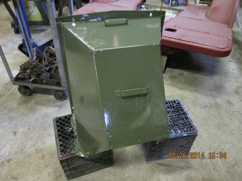

Default one piece at a time !
Few more pieces of the puzzle got some paint.
Kirk Armitage

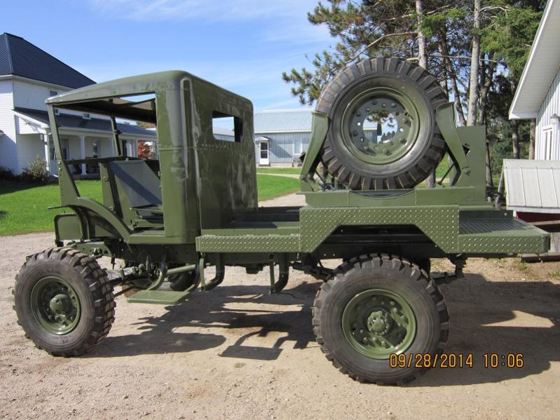

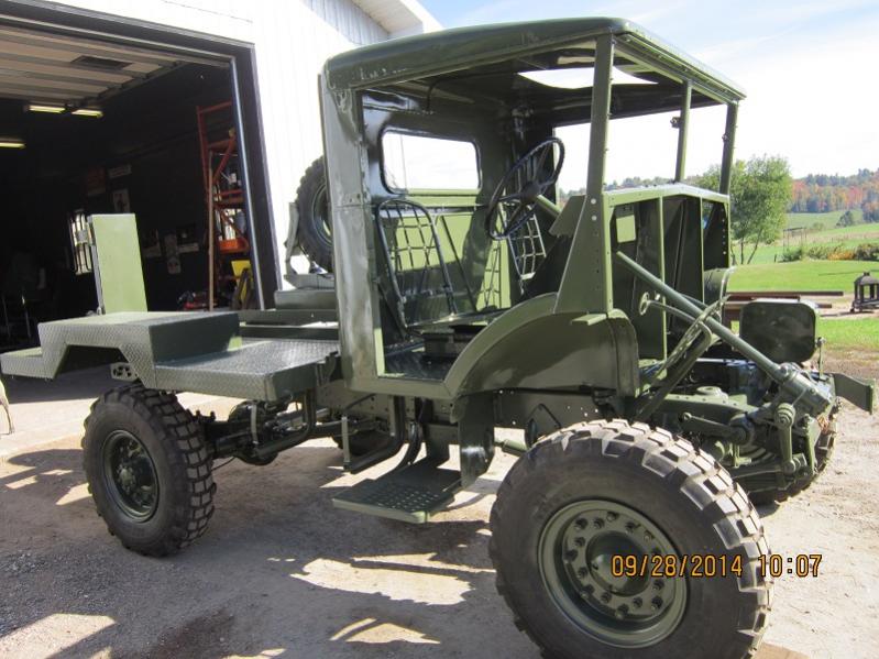

Posts: 106
Default Roof goes on
Still working on the front clip, replaced the angle iron mount, the original had been cut in order to install a hydraulic pump.
The roof has been installed and rolled out the truck for a few pics. Other than the clip in primer, were out of parts to paint, so I guess its time to start sandblasting again.
K Armitage (and crew )
sept 27 2014 KL Resto 002.jpg   sept 27 2014 KL Resto 005.jpg   sept 27 2014 KL Resto 010.jpg   sept 27 2014 KL Resto 012.jpg
