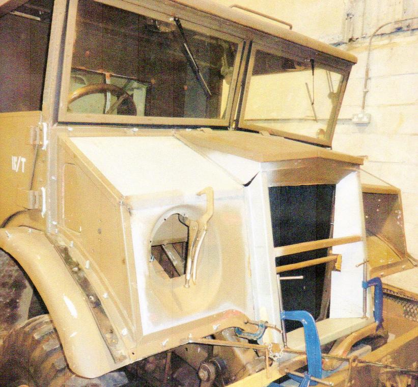

Today saw us weld up the last bits of the front body assy. Pic 1 shows the angle iron welded onto the assy, also the bottom of each wing were tack welded in areas where we couldn't work on earlier as the G-clamps were in the way.
Satisfied that all was well, we were ready for front body assy removal, it was out with the block and tackle and off she came. Pics 2 & 3 show the front assy on the ground blind side up. On Friday we'll weld everything in place on the blind side.

Default The nose is finally welded
Last Friday and today Richard welded, welded and welded a bit more, today the nose has completed an important stage and is available for final assembly onto the truck.
Pic 1 shows the drivers side viewed from the inside and the many welds. The patch at the base is from an earlier life. The top panel is new.
Pic 2 shows the passengers side, the front panel was too ratty to re-use, so Richard cut out and welded the original headlamp bowl into an new piece of 2mm zintec, this was no small feat, as it was done without any heat distortion, the top panel is also new.
Pic 3 shows the centre section and the numerous welds. resulting in a rigid structure that fits the rest of the vehicle like a glove.
Pic 4 sorry the pic's sideways, but it shows what a good result we got from what was a sorry sight at the back end of September. The centre section is welded into a tight structure from new folded centre section pieces making it stiff and strong.

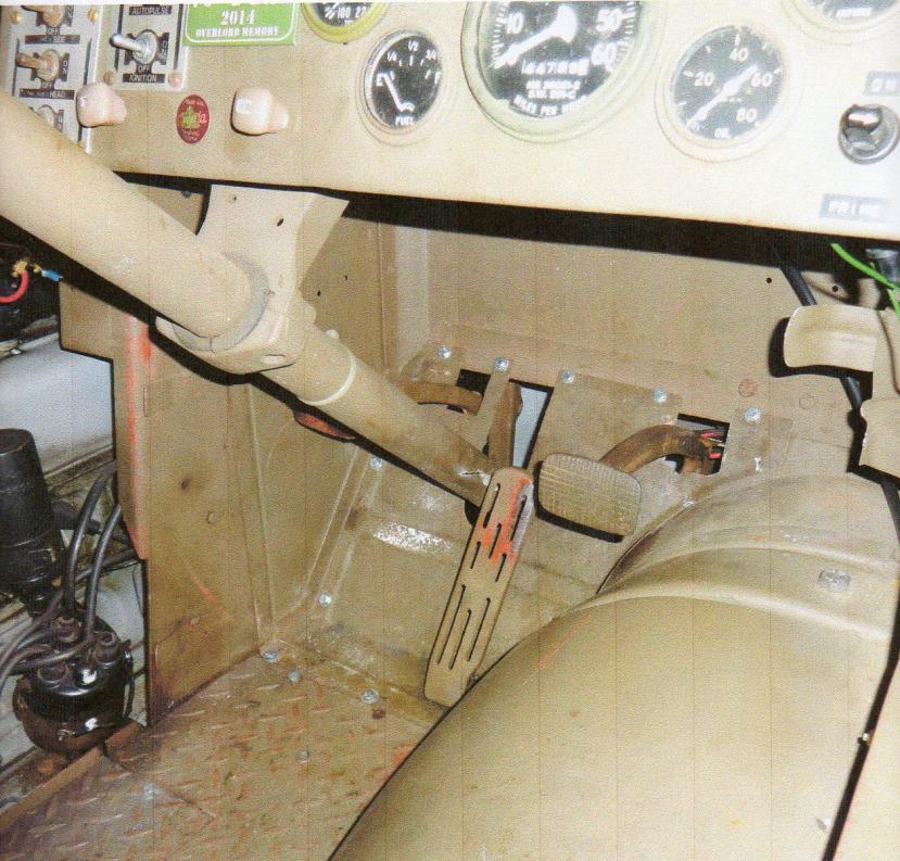

Default Brakes seen to
Hanno, thank you for your kind words. We want to do a good job.

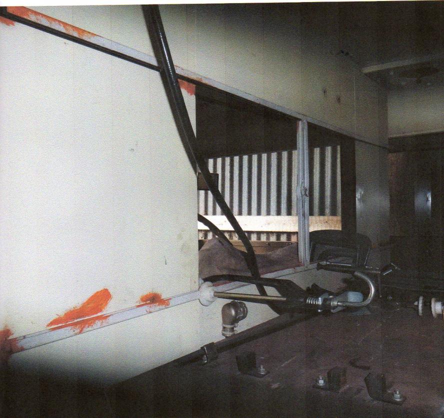

Today we fitted a proper pair of Woodruffe keys to the brake cross shaft and fitted the assy back onto the chassis. What a difference to the pedal and its position, adjustment to the master cylinder linkage will be required to bring the pedal down to allow 1/2 inch of free travel before the brakes act and I need to refit the clutch linkage. I'll do that with the ramp up once we've done the final fit of the front panel assy.
Pic 1 shows the brake cross shaft looking through the headlamp aperture, not a good pic I'm afraid.
Pic 2 the ankle freezer door bolts have been replaced and work properly, the front panel's loosely hung awaiting the arrival of the panel mastic/caulk, which arrived just as we were packing up!! We trial fitted the bonnet and grille, the grille needs narrowing a tiny bit, which we'll do as the grille needs a bit of refurb work anyway.
Pic 3 we need to weld on the bonnet catches at some point, but it's all coming together at last.

A couple of pics for the record, one of the driver's footwell and one of the front end. Lots of detail work needs doing yet, including re-wiring of the front end and the last major job of straightening out the front doors before priming and painting. The latter will wait until the weather improves in Spring.

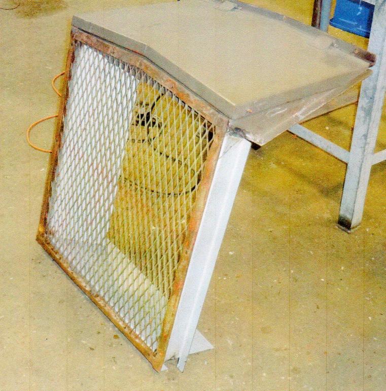

In the last few days I've remade the grille as the replacement I had was a bit ratty. A bit of a grit blast and paint and it's come up well - Pic 1.

I've pulled out the damage to the division between the driver & radio operator's compartment using the trusty ash tree and cargo straps - Pic 3. I've left a couple of clamps in place as I need to tack them back in place.
Started her up and after I'd done with the ash tree I parked her up whilst I went for a cuppatea, couldn't resist a another - Pic 4.
