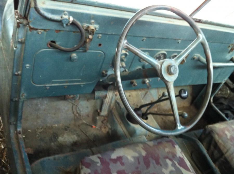

Hi, these are the photos requested! Best regards Bernard.

All M38CDN and M38A1's were stamped with a "Delivered Date" of the format MM-DD-YY or Month-Day-Year. Be warned that the Ford serial number sequence does not always match the date sequence. For example F-200445, 5-5-53 has delivered date much later than F-200459, 2-12-53. So do not interpolate missing dates by comparison with other documented jeeps.
Bernard: your serial number is stamped much more clearly than most however I can not make out the month of your delivered date. It is most likely a 2 , 3, 4 or 5 (Feb/Mar/Apr/May) but take note of my comments about out-of-sequence dates. Can you examine it closely to help identify the month?
The lower right corner has an inspector's stamp. I think it is the common "IS" over the logo with "E19" below the logo, although I have seen variations. Can you confirm? The inspector's logo is often referred to as the "Canadian Tire" logo due to its shape. Can anyone confirm the meaning of this logo or the use of this type of stamp: unique to the inspector at the Ford plant? Seen on other vehicles or army equipment like firearms etc.
Finally: the lowest CFR number that I have seen on an M38A1CDN is 53-32181. Ignoring the date (52 or 53) and the first "3" which is the 1/4-ton vehicle class this leaves only 4 more digits to identify the jeep series of vehicles. Considering these last 4 digits: I believe they started numbering M38's (roughly 2165 made) at 0001 and continued straight through into the M38A1's (roughly 700 vehicles). The highest M38A1 CFR number I have seen is 53-32908).
I propose that the a block of CFR numbers ending in 33XXX was set aside for US-purchased Willys vehicles, rebuilt vehicles, special equipment vehicles or for re-assigning a new CFR number at a later date. The date pre-fix is largely irrevelent: the army only used the last 5 digits of the CFR for assigning a license plate.
Comments welcome. there is lots to learn.
....Brian

Bernard, I got curious about your serial plate; fortunately you posted a good photo. I find it quite unusual - but certainly not to question it's authenticity since it looks very original.
Frank v.R. and others may also notice that there are 3 different type faces used for stamping the serial number.
The most plates have a type face like your "53" date. Notice how delicate and lightly stamped it is. Most plates I have seen have this exact style for the serial number and the date, and are very uniform in spacing and pressure: i.e. machine stamped in one process.
I have looked closely and do not see a Month stamp. However the "2" which is in the space normally used for the Day is a heavy type face: As if it was an after-thought. Also there is a dash before and after the "2" suggesting the original intention of a MM-DD-YY format. One possibility is that the "53" was pre-stamped without a MM-DD. Later only the "2" was added, in which case it may mean either February or the 2nd day of an unknown month.
Finally the F-200578 is definitely a bolder typeface than normal M38CDN and M38A1 CDN serial numbers.
My guess is that the jeep had a problem on the assembly line, was pulled aside and not stamped until it was approved for delivery. At that point a different set of stamps was used and the stamper overlooked assigning a day and only stamped "2' for February.
If you PM me and give me your email address then me then I can send you an image of a typical serial plate.
A most interesting plate and thank you for sharing. .... Brian
