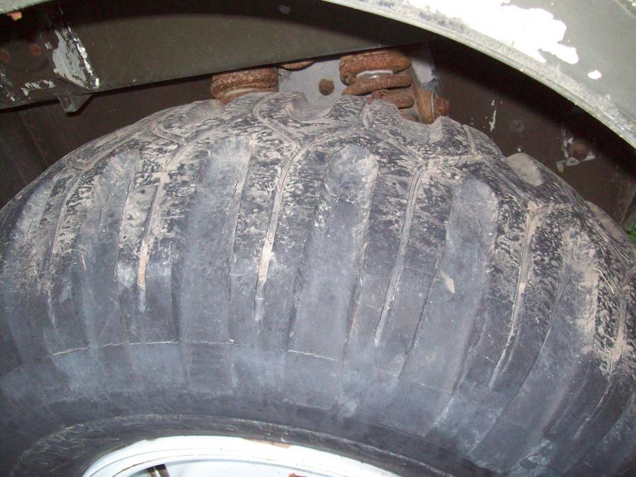

As an aside, I have noticed some of the Chinese tire tread patterns are starting to look like they might be a good fit for our CMPs. Here is a shot of some 8.25x16 tires on ebay right now for $175 a pair.
Old 09-01-15, 18:15
Posts: 5,267
Default That's a lot of rubber for the price....
Looks more like rock quarry tires........ sure could use some sipes for traction on wet pavement.
