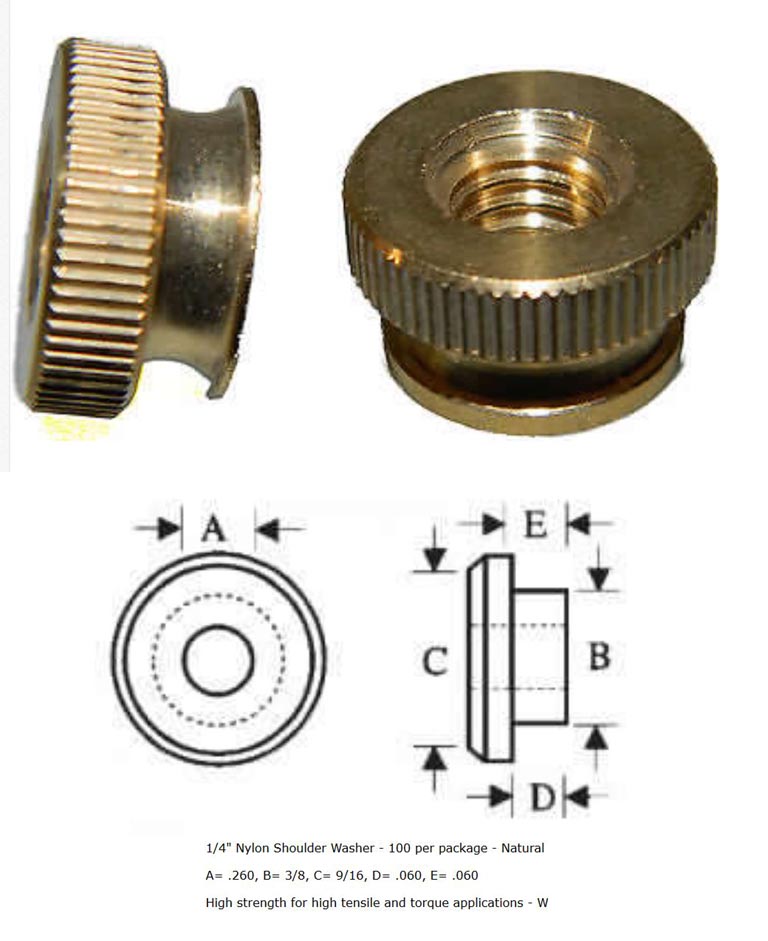

I picked up some stuff in town to reproduce a switchboard. The panel piece is 12" square and the sides are 3" deep. I guessed that the panel is recessed 3/4" and went from there.
The toggles on the switches are the same size and shape as an ordinary household light switch. The bolts that hold the cover plate to the switch are the same spacing as the top switches on the switchboard. Some hardware strap hinges are the proper size too.
I ordered some nylon shoulder washers and knurled thumb nuts off ebay and am watching for some 25 amp or volt gauges to show up. There's quite a few outfits that made analog gauges that would work.
The terminals for attaching wires are 1/4" NC by the look of it.

I am also looking at making the metal cabinet, even if I just stick a picture of the switch gear inside for now. So I guess the hight measurement of 16 1/4" must include the strap at the bottom. Can I query why you made it 12" and 3" instead of 12 5/8" and 4"? Studying the picture seems to show that the doors have about a 1/2" rounded edge, which would add up to the stated depth of 4 1/2". Can I also ask what thickness of material you are using? I am guessing at something like 12 gauge? So 2 -2.5mm sheet. Regards Ron
