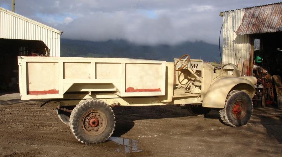

Thanks for your interest. Progress on the truck has slowed down due to other commitments, but we keep plodding along, doing something almost every weekend (we can only work in the weekend). The attached photo shows recent progress on the rear ammo body, which still has one side and the front panel to attach. We will make a start on the brakes shortly and we expect the motor back from the engine re-conditioner early in the new year.

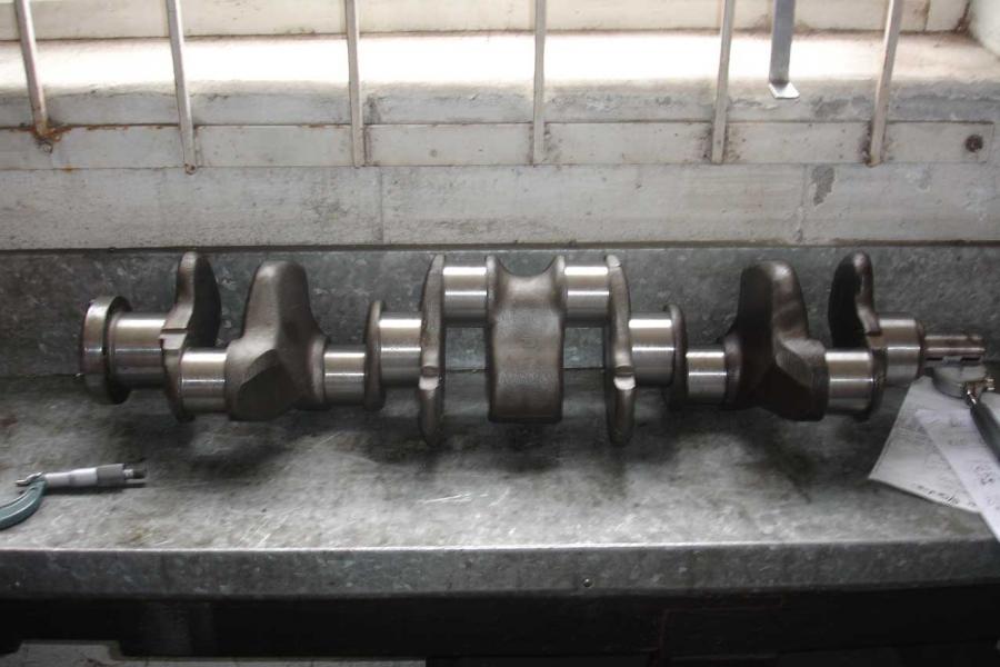

Today we called in to see how the engine re-conditioner is getting on. He is re-grinding the crankshaft, honing the bore, putting in new bearings and new pistons etc. It has only taken him three years.

On Sunday we did a mock-up assembly of the truck to see what she looks like. None of the bodywork is permanently attached yet, but we were pleased to see that everything fits properly and looks right. Its a morale booster, as we are hoping to display her (unfinished) at the Armistice Day commemorations in November. We have nearly finished installing the brakes and have also started working on the gearbox, universal joints and driveshaft.

Yes, it is a boost to the process to see what it is really going to look like. You have done a lot of hard work. It will be a very sharp rig when it is finished.
