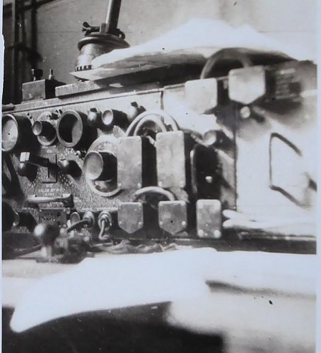

For the WS11 fans... two previously unpublished pictures from an album I have of Canadian Wireless operators training with the WS11 at Aldershot.
Hope these are of interest.
Tim
