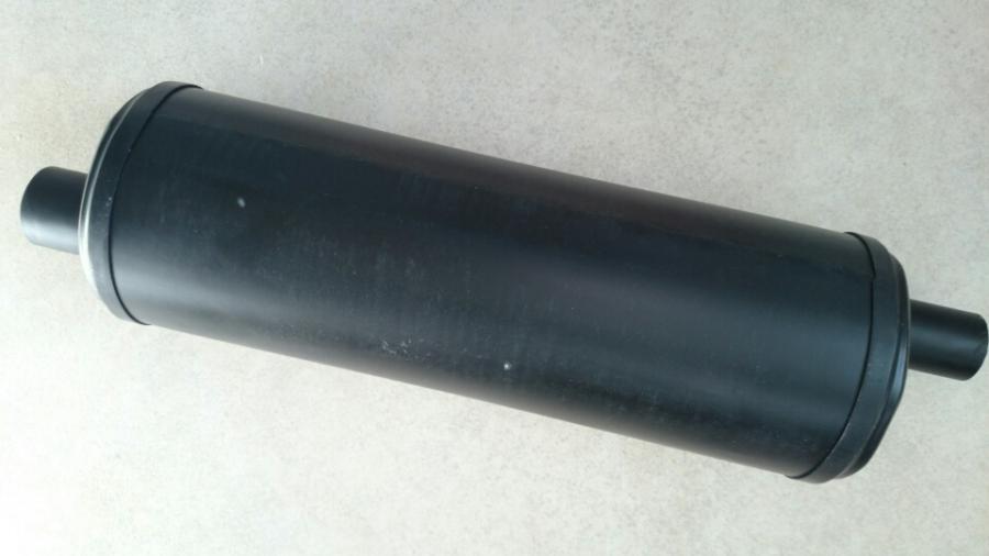

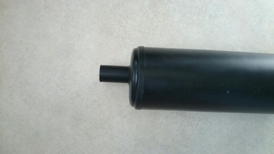

I looked for the guy (in USA) that made my CMP muffler to order, but looks like he isn't on ebay any more. At least my original link to his sales is no longer taking me to his wares.
I'll keep looking.
ID:	77466 Click image for larger version
ID:	77467 Click image for larger version
The above photos are the muffler I had made to specs acquired from folks on MLU.
If I can track down the manufacturer, they can make to your exact requirements.
