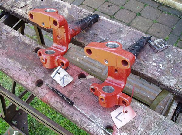

Next up was fitting the front suspention with some new bushings, pins and bearings. I was lucky enough to find a new set here in Holland. Removing
the old bushings and fitting the new ones was an easy job with help of the vise and a 19mm socket.
Afterwards the bushings had to be reamed to the correct size to accept the kingpin. The blades on my reamer were too short to work on both bushings at the same time....in other words there was a risk the surfaces of both ends would not end up inline, but at a slight angle. To solve this I made some plastic bushings on a CNC mill that would fit just around the shaft of the reamer and would just fit inside the bushing. I was quite happy with the result as the kingpins fitted perfectly after the reaming was done.

The kingpin set did come with some shims, but sadly not the sizes I needed to get both pins within spec. I tried to find some extra shims here in Holland, but didn't have much luck in finding the correct diameters.I tried to have a few made, but the trouble was that I wasn't able to find anyone who was willing to make just a few....as they had to buy a whole sheet of material just for this job.
I did find a set of correct shims at Speedway motors in the US, but I was impatient, so I didn't want to wait to loose days to transport...So, in the end I visited the local department store and bought the first cheap stainless China product I could find that had a flat surface big enough to make a few shims. I think it was some crappy dinner tray.....but after some work with a Dremel tool, it's now part of my Front suspension.
I am very happy how it all turned out...all within spec.
