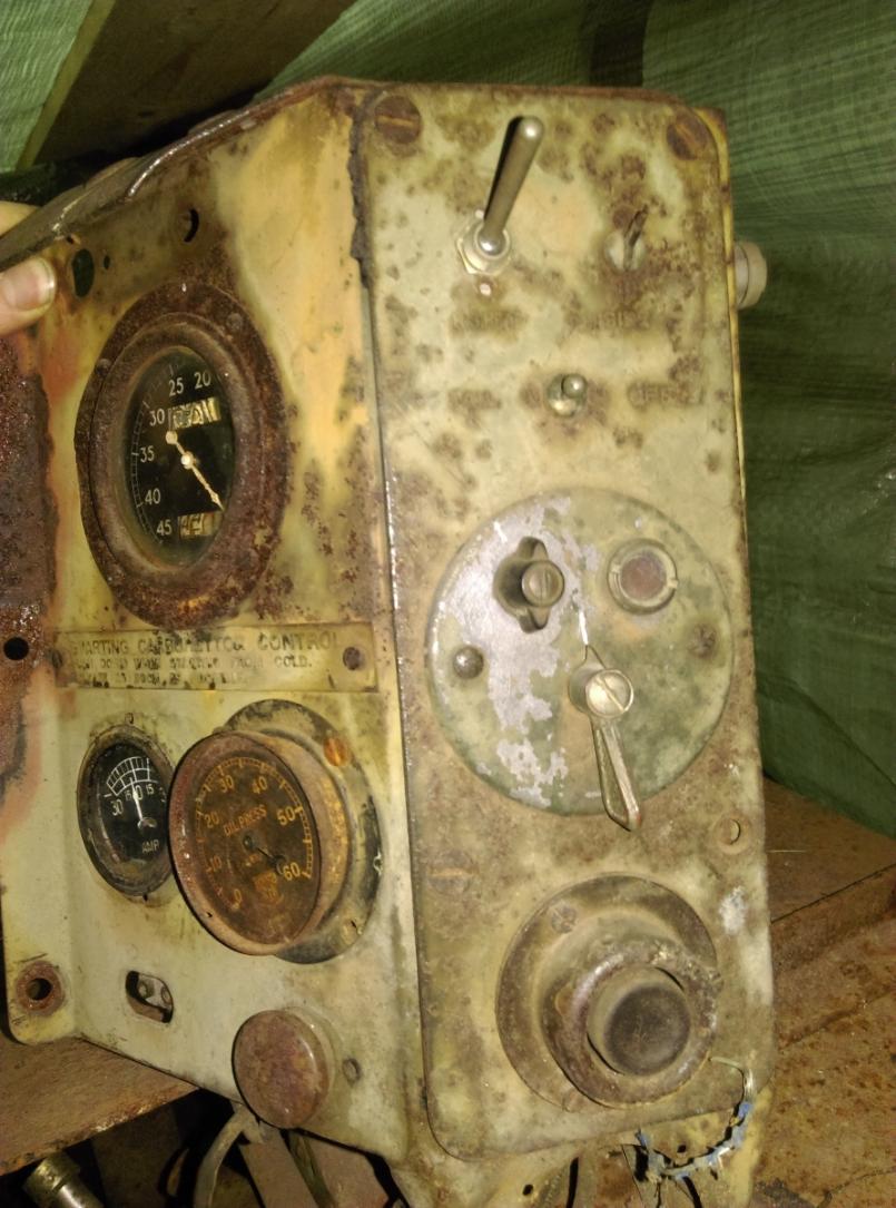

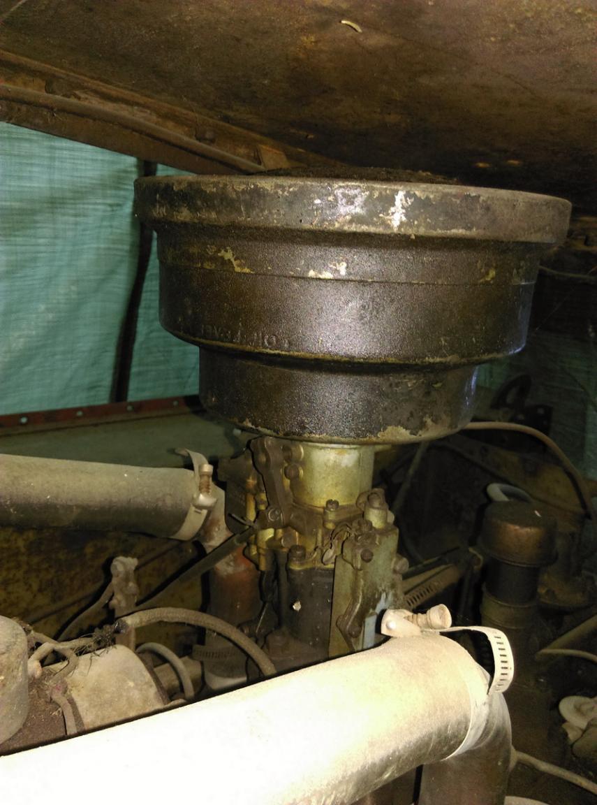

I believe your driver side rear upper engine cover is complete with the air cleaner instructions. That style air cleaner installed to SN #5787. Although mostly replaced by the oil bath cleaner, an early one was available for sale at the fall, 2015 OMVA meeting.
Your switch panel is the correct British type. From the view of the back of the speedo, it appears correct as the Brit one.

Few new details, the carrier is still under the tarpaulin cover until I'll finish the workshop expansion. I noticed there are no holes on the division plate, where the dataplate is usually located. Am I right, they were never present on those early carriers?
Michael yes, the air cleaner instructions are present and are present as well as the original air cleaner.

It also has an original British Light/ Ignition switch assy.
The steel buttoned horn button looks like it is original, but I have not seen one like it before.

Thanks for info! Here is the horn button from the side view:

Another details of the current condition, engine compartment.
