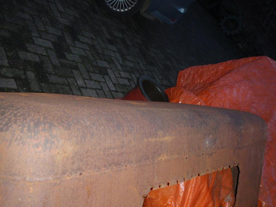

Default Body Building on the C8A
Some heavy metal body building going on.
After a lot of measurements we finally continued on the body building of the C8A, we try to get the frame finished by this year so that we can start sandblasting, and add primer.
when ready things will move fast I guess, with an new soft skin this lady will shine again

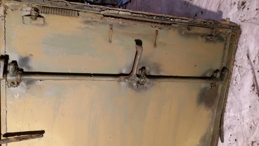

Default Hatch continued
I did some surgery on the hatch lever, mine beeing totally corroded however the section gives a nice vieuw on how the hatch is build up and how the lever
moves into a piece of tubing.
I need to rebuild the whole thing....

Default Help needed on hatch info
Please see the pictures of the hatch lever that is located outside the hatch and inside the slide rail (a simple U profile)
You can see that the ball part has extensive wear and is flat on one side.
All levers on the hatch I have are having this flat spot which indicates to me that these ball didn't roll but just slide .....is this correct or should they indeed roll which seems obvious to me ...did any of you ever made new levers ?? I'm wondering with what I should replace this ball, seems to me that it's hard to make or to obtain as a ready made part......any suggestions welcome
Many Thanks

Hi Pieter
Yes the bronze ball wheels were intended to turn, but it never seemed to have worked very well. I have never seen a HUP hatch where some of the balls are not flat spotted.
Some of mine are flat spotted in more than one location. My long ago fix for this problem was to smear grease on the rails which does make the hatch slide much easier.
The bearings would need to be pretty small and rust proof.
I still have to fit the new roof hatch on my HUP when I did the restoration ran out of time even though I have new track and new hatch all fabricated just didn't have time to get them fitted so put the old hatch back on.
The lever ball unit unbolt on mine to be removed so I think the first step will be to remove all four and drop them in a bucket of acitone and automatic transmission fluid to see if they will loosen up and turn.
- My additional questions:
The bronze used on my late production HUP, June 45, seems to extremely soft was this the case on early HUPs?
The end of the shafts on my lever arms are swedged to the keep the balls from falling off was this the case on all? Seems like they would only be lost prior to installing the hatch on the vehicle.
PS If the spelling is off in this post, the spell check on my tablet seems to have stopped working.

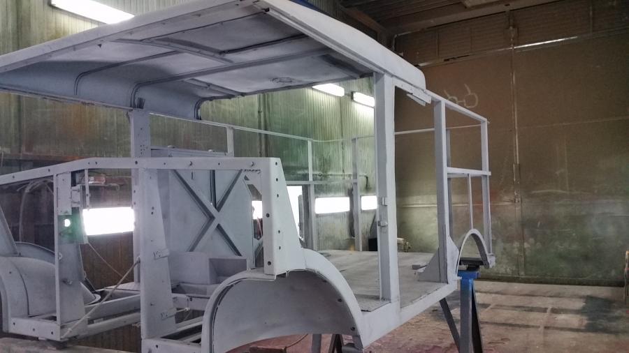

Default Some new progress on the rebuild of my HUP body
Today the body got sandblasted and primered

Default Here the primer part
Here the pics of the primered body
