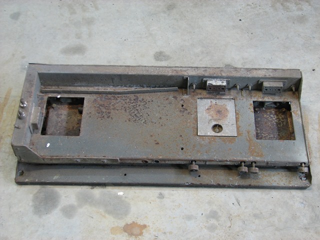

Here are a few more pictures of the parts that came with the M8.

In between waiting on news on the hull and getting my scout car parts sandblasted and painted, I did some work on the instrument panel.
I think with the likely manufacture date of this M8, it should have the early instrument panel which is what I have.
I had two pretty rough instrument panels and their switches and gauges to work with along with some new gauges that came with the package.
I am not set on the paint shade that I have used for the panel colour but it will do until I narrow that down later on. I worked off some NOS parts that I had which I gave to the paint supplier but I am not totally convinced after seeing it on the instrument panel.
A question on the circuit breakers. I know nothing about these. Are they lit when operating at all? What is the original colour? These ones had several coats of paint on them which I have cleaned up so am wondering whether I can touch them up with some original coloured paint to freshen them up.
I still need an ammeter and a headlight switch. Neither was recoverable from the instrument panels I had. Is the headlight switch the same as the jeep one? It looks very similar.
I’ll also need to find some sort of cover for the instrument lights.

I had a look at the FT-237 radio mount and the radio tray. As you can see there is a fair bit of work in restoring the FT-237 so I have put that to one side at present while I concentrate on some of the other stuff.
Merry Xmas!
