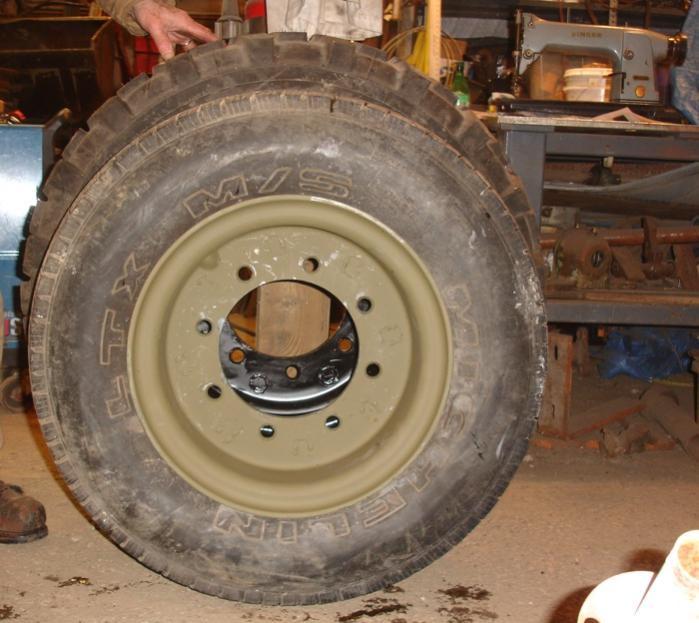

Default Tire Instal Part 4
Now for the dry run.....
Pic 17- Tire is just barely balanced on the bottom half of the rim. Actually had a tendency to iether slip on one side or the other.
Pic 18 Looking at the isnde of this dry mount....... the side further form the camera was slightly lower than the front side..... that is where the tool comes handy in leveling this difference.
Pic 19 We have installed the top cross inside the rim....... a little tricky as the side walls were stiff and the push block had to be squeezed in. Two bolts are installed for this dry installation/illustration.
Pic 20 & 21 shows how the push blocks are resting on the bead. Not even at this stage but when we do the actual installation the high side would be srewed down first then alternate to keep the cross even.

Pic 41 We slowly inflated the tire and at 16 pounds the top was fully seated.
Remember the bottom is not done yet so resist the temptation to flip the tire by hand and get caught...
The top really moved very slowly. As the pressure inscres you can hear the tub/flat/ beads creak a little.
At 24 pounds the bottom half slowly popped in place...... continued to 40 pounds.
That's it!!!!!

I have decided that my difficulty mounting the Michelin LTX tires on CMP rims was largely due to more flexible sidewall and bead structure. After a couple of false starts I added an auxiliary pusher made from short bits of 2x3 and 2x4 lumber powered by a C clamp to push the bead around the curve of the rim. Once round the curve, the cross pusher worked fine to take the tire further down the rim ready for the tube and flap. The other half of the rim went on exactly as expected, Put the rim in place, tighten the rim halves together and add air to ease the tire into place on the rim. Photos attached show the wood addition to tooling, the tire half mounted and the finished product.
Also comparative photos showing the LT235/85R16E LTX against the STA chevron tires in 10.50-16 size and against Michelin XL in 9.00-16. Although the LTX look small in comparison, they are rated to carry over 3000 pounds which is actually slightly greater than the rating of the 9.00-16 CMP tires (although they were run over capacity for some of the 15cwt trucks).
wood push block.jpg   LTX half installed.jpg   LTX installed.jpg   LTX vs STA chevron.jpg   LTX vs XL.jpg
