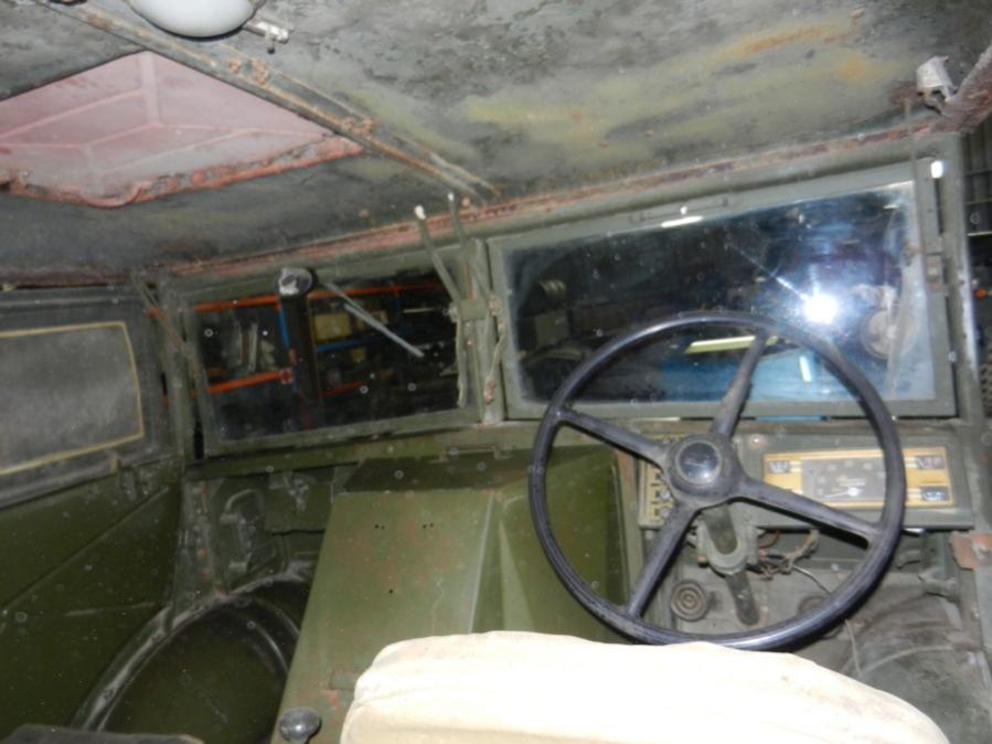

Here are a few shots of my FGT.
I have no idea what the slots on the rear drivers side ledge where the spare is stored are for not the bracket with the bolt in it. behind the spare wheel.
There is a bracket on the outside next to the back left door with a pad riveted to it that also eludes me.
Here are some pics with the last being a banner I found in the left storage hatch .

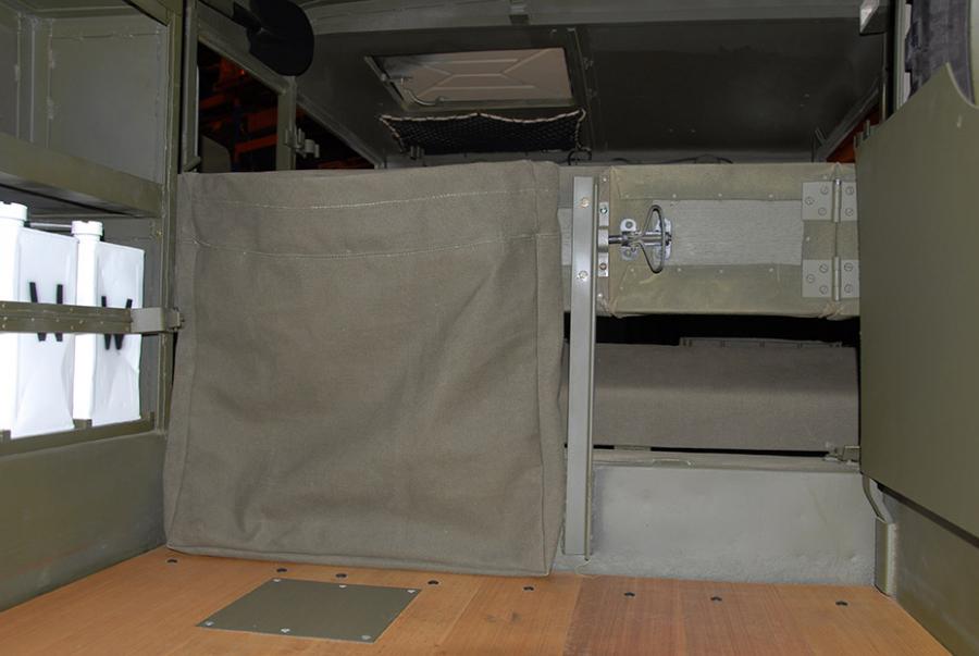

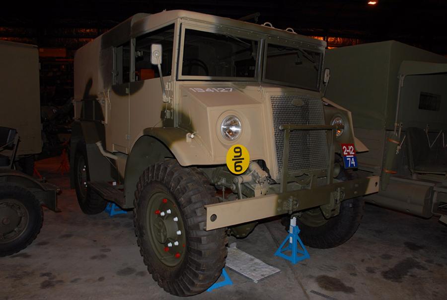

I took some pics of the AWM's restored composite No9 built using the chassis of 134127 (which is how it is marked) and body 134707, body number 105.
It was restored several years ago by a contract company. Not all the details are correct such as wrongly painted parts and clear coated rear floor, but it is a great thing to have a FGT No9 in the national collection.
Hope these pics are helpful.
Old 19-01-16, 01:03
[user name reset]
Join Date: Oct 2012
Posts: 392
Ohh very helpful indeed
body and body serial are different ?? my body is 123

I was underneath today trying to find the serial number...doesn't seem to be on chassis rail near stbd engine mount. I noticed my diff convoy light is in a different place to that on the AWM. Mine shines on the port side of the Banjo . I rubbed the Banjo back and the original white paint is there on the port side and quite a fair way out so the part where the axle outer joins the banjo un to about half way up th banjo .
Also the little red green convoy light switch is still there.Post Army use someone has replaced the Banjo convoy light with a spotlight that illuminates the winch....

does anyone have a view on the markings on the AWM FAT??
Mine is from 21 field regiment RAA . I thought the bi coloured thingy came in after 1943??
and whats with the yellow number circle ??
The disruptive looks about right for 1942/43 light stone and KGJ
Old 21-01-16, 22:34
Posts: 2,402
Gina,
ARN 134804 had the original engine number (and therefore, chassis number) 3G47304F. The vehicle was taken on charge in Queensland. It was disposed of from 2BOD (Moorebank? Liverpool?) in July 1957.
My notes concerning the entry are interesting: like many of the No.9 FGT, the model is listed as an 'F60S'. Also, the chassis number entry is left blank: only the engine number was listed, a common occurrence when the engine and chassis numbers were the same - particularly with Ford jeeps, for example.
The AWM example follow's the AMF's post-August 1944 markings scheme, in this case, for 2/12th Artillery Regiment - 2-12 being the unit marking (the '2' indicates a unit originally raised as part of the 2nd AIF) and 74 being the unit type marking, in this case, a field artillery regiment. The background colours of red over blue, divided horizontally, are the arm of service colour code for artillery. I don't remember the Formation to which the regiment was assigned in the late 44, 1945 period - that symbol is only just visible on the flat in front of the left side windscreen, painted in white on a black background. The cam scheme approximately follows one of the issued patterns (as per the instructions at the time) for the period when the vehicle was built/delivered.
The 9/6 is the bridge plate, with 9 being the class when laden with towed load, and 6 being the class laden without the towed load.
It's a long time since I dealt with the instructions to the restorer, so my memory of the specifics is a bit dim. Unfortunately, I departed the AWM on LSL prior to the completion of the two vehicles (F15A and FGT), so the latter stages (of assembly and painting) were under the direction of a conservator.
'T' numbers are generally not listed in AWM126: there are exceptions to that statement, but not for M3 Light, which is the area I think you are most interested in?

If the scheme on the AWM veh is 1944 why not over all KG3 as per the instructions...or is the supposition that in 1944 it may not have been over painted??
you previously told me the Unit sign for the 21 Field regiment was a red blue horizontal square as in the AWM shot with the number 76 on it....now to decide if that is on the vehicle or on convoy plates...
Hmmm I can't find a 1942/43 shot with convoy plates and which side does the division sign go ...same as the Tank?? which appears to be on the port side on the front and stbd side on the rear....
Old 22-01-16, 01:40
Posts: 2,402
Hi Gina,
From memory, we decided at the time to stay with the 'as issued' scheme which follows the classic period images of the No.9, especially as there was no guarantee that the tractor would have been repainted in subsequent schemes as they were issued - often, they were not. The tractor is a type example with no known provenance, hence the above. The cam and markings are simply a generic set.
21 Aust Field Regiment were attached to 1 Motor Division in 1942. In June 1942, the issued signage was 62 in white on the artillery background of red over blue.
By May 1943, the unit formed part of 3rd Armd Div (the re-formed 1 Motor Div) with the unit sign 76 on the red and blue background (as per my previous info to you).
Both 1 Motor Div and 3 Armd Div used the same formation sign of a greyhound over a boomerang, in white, on a black background.
I don't have a record for 21 Fd Regt after August 1944, so don't know where they ended up after 3 Aust Armd Div was disbanded. However, the unit sign would have been 21 over 74 in white on a red over blue background.
All the artillery Unit sign Arm of Service colours red/blue referred to above were horizontally divided, top half red, bottom half blue.
Location of signage is as per the AWM example: front left, rear right. Cannot remember if the No.9 has plate holders on both sides of the rear or not, but generally, the Formation sign was painted directly on the vehicle, usually above the location of the unit sign, while the Unit sign was on the removable plate (which had the word 'PASS' painted on the back, in black, on the vehicle base colour KGJ or KG3).
