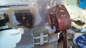

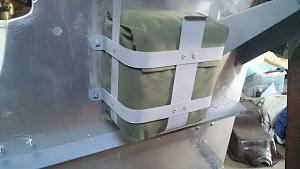

Put the cleaning gear bag and its 'cage' onto the shield today.
ID:	79515 Click image for larger version
Also made a trolley to move shield around easily. It's starting to get ackward as it gets heavier, and I didn't fancy the top flopping around while I work the parts to secure it up or down. Think I may have engineered a problem with the upper shield securing latches. The ones I have are bigger and while that isn't necessarily an issue, they may need to be relocated to avoid fouling other things. It happens!

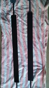

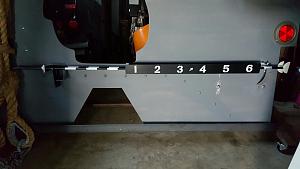

The ranging sticks are nearly finished. Only the white parts and numbering to be done. I'll let the black paint harden a bit before I try putting masking tape on it. The numbers I'll print tonight.
ID:	79518 Click image for larger version

Default Ranging sticks
ID:	79573 Click image for larger version

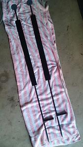

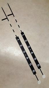

Getting there with the sticks. White bands to be done on the posts, and some black on the round tops, then I'll call them done.

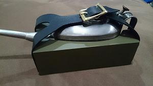

This is the oil can base I made last year some time. Not accurate to original, but I'm OK with that. Enjoyed making it, none the less.
Still looking for an illuminating apparatus case to buy!
No pressure.
Does anyone object to me posting photos of the parts I make, amongst the requests for information, on this thread?

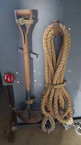

Yay. My military shovel arrived today, and I couldn't resist doing a test fit with the original drag rope along for the ride. Heavy bloody thing it is too.

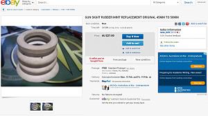

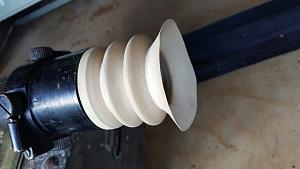

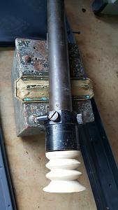

I also ordered an original telescope rubber eye piece, from same seller. It is in absolutely mint condition. Very soft and pliable.
ID:	79614 Click image for larger version
At least one more is available, but may not last long at $27.00 including free shipping within Australia.

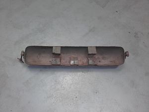

Do I understand correctly that the instrument was 23" long x 2" width? I have a very nice piece of 6mm thick aluminium plate that would fill out a canvas cover quite nicely. I can get the bracket dimensions and footman loop placements from my local gun, but are there any other specs or info I need to get this right?
One more question. I have seen many variations of finish on the 'head' of the range sticks, and even seen some partially painted red, so my question is.....how are they meant to be painted?
P.S: I take it that the chap in background of the 25pr photo is probably NOT interested in military history!
Old 10-02-16, 16:14
Rob
Location: Yorkshire,UK
Posts: 810
Aiming post heads should be Black and White.
Rob....................rnixartillery.

The No.20 Fuze Indicator (ie the slide rule) mounts are 690mm apart, and the top edge of the brackets are 18mm from the top edge of the shield. The right hand bracket is positioned 40mm inwards from the right hand edge of the shield.
The two footman loops are 125mm from the top edge of the shield, and the right hand one is 230mm inboard from the right hand edge of the shield. The Loops are standard 55mm centre to centre, 15mm deep loops.
The base of the bracket measures 80mm x 43mm, and the depth of the part that holds the Indicator is 20mm deep, 30mm wide. The brackets are held on by 3 rivets, round head type, with the round heads to the outside (front) of the shield.
Measurements are from your local gun at Tiaro.
I have a good drawing of the No.20 F/Indicator in a Canadian parts book if you want to try and do any replicating, or have it for reference in case something like it comes up for sale.

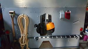

ID:	79798 Click image for larger version

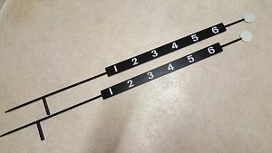

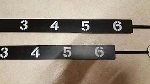

The ranging sticks are finished. The white stuff you see in the retaining brackets is cotton material to avoid scratching the sticks. Have since obtained some thin green felt to use permanently....after painting, of course.

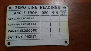

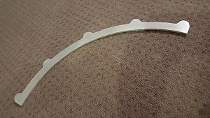

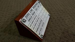

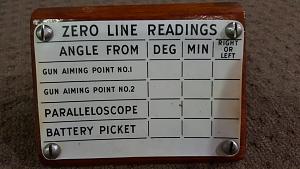

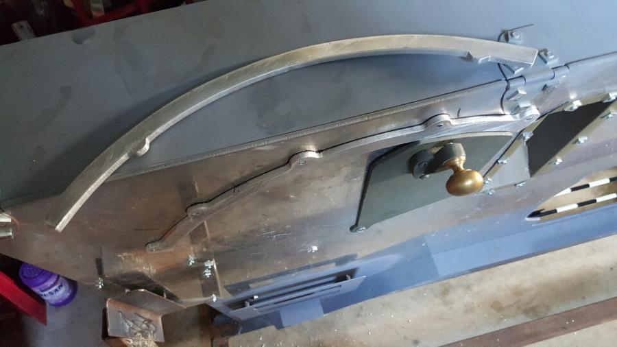

And, the zero plate and block have arrived from Rob N. I'm cleaning the plate right now. The wooden block is a work in progress too.
This weekend I want to make the track for the sight door to slide in.
Made templates for that, one night through the week.
Bought steel plate to make the brackets for the two wooden boxes.

Rob N, here's your zero block. I tidied it up a little. It will be attached next Sunday.
ID:	79842 Click image for larger version

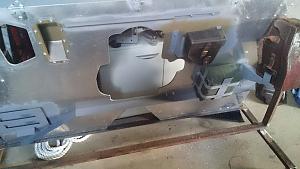

Because of a transient episode of laziness, I only spent a couple of hours in the workshop today. It took me nearly all that time to fashion the following piece, being one half of the sight door sliding track. I think it's the harder of the two parts to make, so other one shouldn't be so painfully time consuming. Two hours of hand filing is my limit, I'm afraid. Never again.
It isn't really wider on the right hand side. It's a trick of the angle of photography.

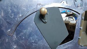

I made the second part of my sight door slide last night, and I was correct that it took only a fraction of the time to make. Now to join the two pieces without obvious signs. I have a cunning plan, get someone else to do it.
ID:	79911 Click image for larger version
Decided to briefly afix the part of sight door track that goes aginst shield itself. I wanted to be absolutely sure I had filed the correct amount for door to sit nicely against it. Then measured the minimum distance I can overlap the top piece to the door, and what do ya know, I won't need to shave any more metal off the width. May thin the thickness about 0.5mm once the welding has been done. Welding will be about a two minute job, literally.
Incidentally, the part sitting on upper shield in first photo, is laying face down, so it's bass ackwards! Left is right, and right will be left.
