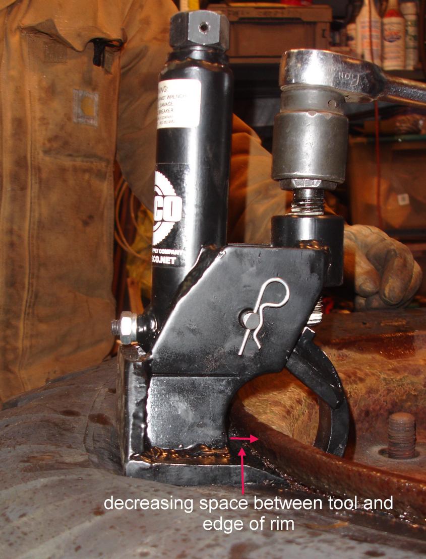

Tool is weld made....simple construction. Yo will noticed that the claw that losks on to the inner face of the rim has been beefed up...... the Ebay picture did not have that improvement.
Wanting to know how it was made and under the pretext of seeingeif the inner thread was greased we took it apart. Simply remove the lock nut and set screw. The end of the set screw fits into a key way cut into the foot bar and keeps the foot from turning....... a problem that was resolved in there HD $600 model which uses a square tube.
Yes there was some lubricant.... but knowing the heavy load that we would be submitting the tool to we recoated with Never Seize grease and put it together again.

We fished out a CMP rim that had a blow out a few years ago and was left outside with Mother Nature.
By the way the tool does come with pictures and instructions. They DO NOT recommend using a air impact gun but a air ratchet gun may be used. The difference is the air ratchet only get up to 90 foot pounds and the typical air impact gun in 1/2 in. size gets about 450 pound.... the 3/4 we have does 900.
The air ratchet is useless unless you are just taking up the slack in the bolts. We used a HAND ratshitt with an 18 in. handle and Grant who did all the heavy work did admit that it took some muscle power.

The tool works best with two people since you have to tap the base of the tool for the wedge to fit under the rim's edge.....at the same timeas you lightly tap you take up the slack on the claw that pulls the foot in deeper.
So tap tap thighten tap tap tighten....... don't go wild you risk cutting into the side wall ( which we did not care as it was toast) until the free space between the throat of the tool and the edge of the rim is closer..... we went to far and chipped a corner of the foot...... not a big deal but should be avoided.... we simply unscrewed the claw bolt a half turn and went on.

Obviously the first section you use is the hardest...... a small block of wood to prevent the tire to flex back is useful.... we used the rim nuts.
After repositioning a few times we started to see the inner edge of the rim..... this is after 4 separete tries.

CONCLUSION....... The tool was never used with a air impact wrench but nonetheless it has its limitation and can be overworked using a 16" hand ratchet. Once the resistance of the tire bead on the rim gets too high the holding claw which should insure that the foot inserted under the rim starts twisting this imparts the same twsiting motion to the tower of the tool..... the more it twist the more the foot slips out and the more the claw bends.
I am confident that a claw made of solid steel with a greater cross section will be more resistant to the twisting action.
Bottom line ..... on some really badly rusted rim/tire it maybe wiser to resort to the various proven "cutting methods" used by members OR spend the big bucks for the professional hydraulic models or visit your local truck centre and pay the man.
Meanwhile we are going to rebuild our model to be more resistant to our heavy handed approach and keep the worst tires for the chainsaw and chisel.
The Barn Boys
