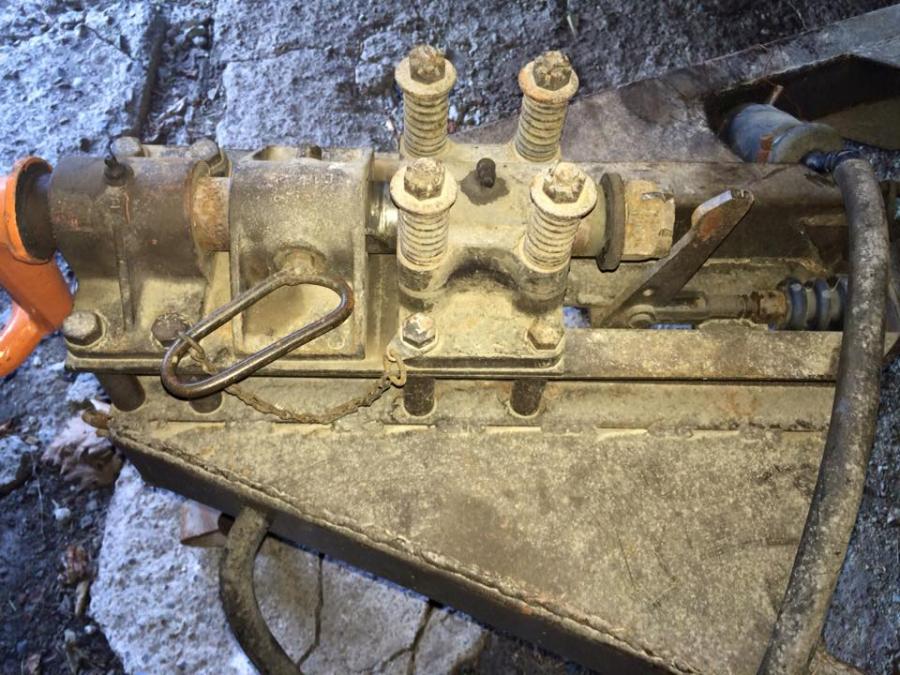

One interesting point that I can't quite figure out. The front mounting brackets for the tow ring are back to front. The mount with the 4 springs should be located at the front end of the trailer. However it isn't a simple swap the parts around as the hole spacing is different and the frame is welded to the trailer. I wonder if this was a production error that slipped by the inspector.

Lastly the back to front tow ring setup.

Looking at the pintle setup, it looks as if all of the parts are fitting well with respect to each other. You would think they would have wanted the two solid supports as far apart as possible for strength (with the friction block between), that doesn't seem to fit with your parts or the manuals. If the drawbar is different diameters in the solid mounts and friction areas, that would be just too much to be a production error (manual seems to show only one diameter). I agree the photos in the AEDB Design Record and the Maintenance manual both show the friction block at the tip of the drawbar. One theory might be that the manuals used photos taken early in production and that a change was made part way through for an unknown reason. Another theory would be Brantford Coach & Body making the assembly one way and Frost & Wood doing it differently for their production. It will be interesting to see what others have on their trailers.
Is that a grease fitting on the top of the spring loaded part of the drawbar assembly? On the 15 and 20 cwt trailers, the spring loaded part contains friction blocks to reduce fore and aft surging against the brakes and there are specific cautions not to lubricate this area. I'm curious what you find when you open this area - steel, bronze bush, brake lining material?

I found another trailer that is in Italy with the same setup. However it is missing the two frame rail risers. It still has its data tags on it and I have emailed the owner for more info.

I am not a vehicle design engineer but I think I prefer the way your trailer is built over the design shown in the manuals. The way it is shown in the manuals, the springs are under constant load to support the tongue rather than just providing a friction load.

I heard back from the chap in Italy. From him, the steel bodied trailers had the springs for the tow ring at the rear whereas the wooden bodied ones had the springs at the front.

The AEDB Record photos show both the composite body and the steel body with springs at the front with the springs at the front. This could fit with his statement if the photographed steel body was on a carry-over frame. I have no proof either way on this but the composite body was described as 10-P-GS-1 while the steel body was 10-P-GS-2.

The Illustrations in "SB-8A, Maintenance Manual, 10 CWT. Two Wheel Trailer, June 1945" all show the drawbar set-up like yours with the springs to the rear

Conversely, the images in "Box Opening and Trailer Chassis and Body Assembling Instructions for Model 10-P-GS-2 Two Wheel Trailer Chassis and Body" show the drawbar set-up with springs to the front.
I presume that there must have been a production change.
Note: There is no official date on these instructions (there is an ink-stamp of Feb 6 1947 but this stamp also appears on the first page of the maintenance manual and is likely the date when a unit first received these documents)

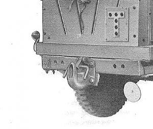

Lastly a bit of a mystery item that doesn't show up in the parts listing or the wiring diagram. An extra side mounted tail/stop light. This was in the SB-8A manual only.
Name:	tral light.JPG
