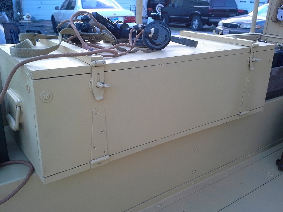

It's been a while since I've posted with progress on the C8. Been taking it to shows for the past couple of years, but thought it needed something new...
I got the itch to put a ws19 set on the truck. Bought a cheap transceiver, and figured I was half way to a complete set...boy, was I wrong!
Anyway, here is where the set is as of today. Still need some cables and such, but now see light at the end of the tunnel..
The transit chest is probably not correct for war-time use, but it certainly is handy. Original Bren chest hardware on it courtesy of Rob Love.
Thanks, David

Gald you are still alive and kicking.
There were some kind of similar chest used by the military late in the war....some black and white picture showing them stacked up like cord wood.
The old style hardware makes it look good.
Bob C

Hi Bob and Tony, and thanks for the replies.
Bob,
Yes, I saw some photos of a similar box also, (I think they were post-war Italian), and that gave me the idea to make one. It will work well for me as I can take the entire radio and all components off the truck in just a few minutes when needed.. We have an event and parade coming up here in a couple of weeks for Medal of Honor recipients, so I can easily yank the whole set out to give people a place to sit.
