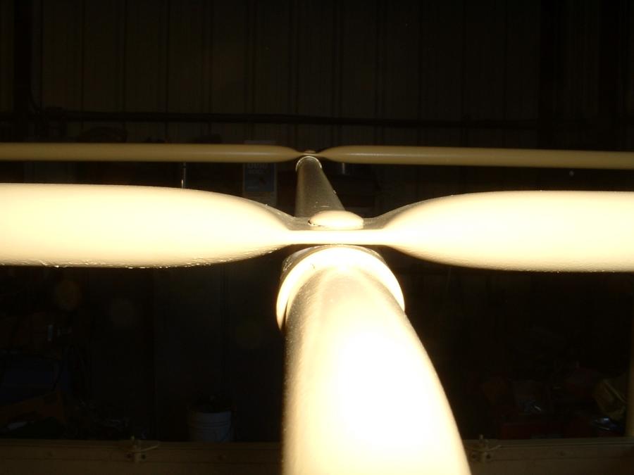

Hi,
Got the creative itch this week and decided the C8 needed a canvas top frame. Went with local hardware store materials to make the frame. Rigid pipe threaded electrical conduit, fitting and pre-formed pipe sections were used for the top bows. Normal light weight EMT electrical conduit was used for the horizontal braces. Sure makes the truck look different......I like it!
Thanks, David

The normal light weight electrical conduit can be bent fairly easy, but was too flimsy to make a decent top frame out of. The rigid conduit I used is heavier and threaded, but not as heavy as iron water pipe.
I borrowed a 3/4-inch pipe threader from my brother, cut and threaded each piece, and used the threaded connectors that are sold to use with this type of conduit to join everything. The curved pieces are sold already bent and threaded, and were the radius I wanted, so that worked out good.
The horizontal top pieces are the normal lighter conduit I flattened with a press to make the connection points with the bows. I used two 1-inch pieces of square bar stock on either side of the pipe to flatten the center connection points.
The rigid conduit is galvanized, so to make the paint stick I brushed on a phosphoric acid "metal prep" solution and waited overnight before painting..
I really haven't decided what to do about the canvas yet....any thoughts or suggestions?

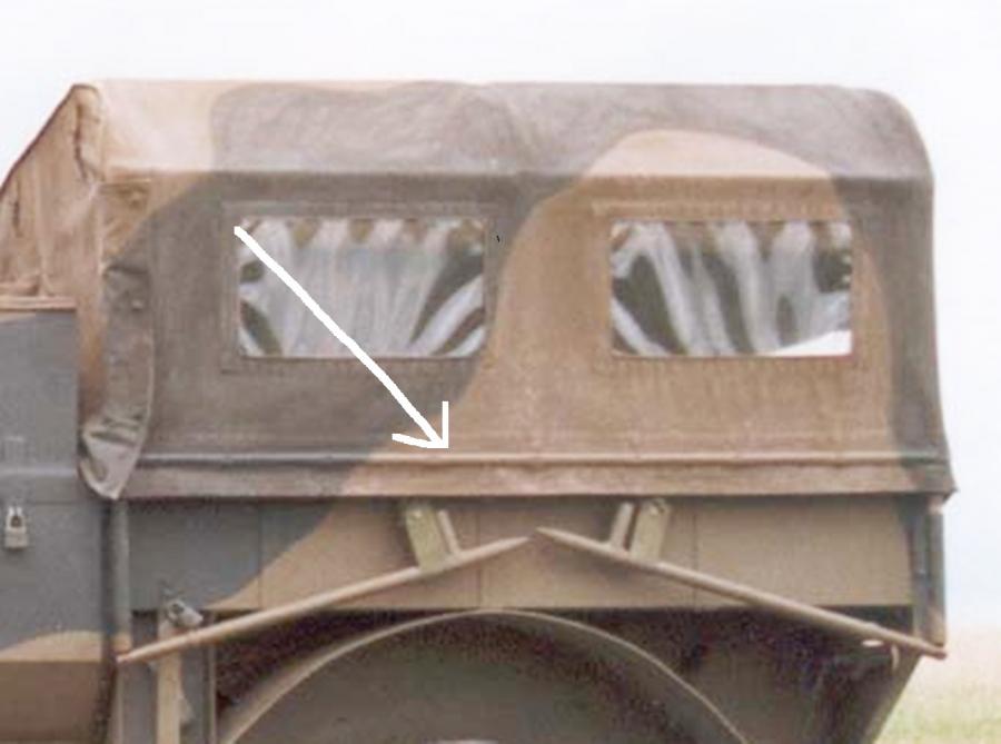

Been browsing photos of the canvas top construction for the C8, and had a question about how it was held down on the sides. The photos show what looks like a metal strap that runs across the lower part of the canvas. Does this strap hold the canvas to the framework? If so, how?
Also been looking for canvas material, and the heaviest canvas I can find in the color I want is 12oz.
http://www.tractorsupply.com/tsc/pro...n?cm_vc=-10005
Does anyone have a source for 24oz canvas in tan?
These canvas framework and canvas are fairly complicated for the 8cwt trucks. Still have to make the four folding legs for the framework, but I think I have that worked out.......maybe.
Thanks, David

My Morris still has the folding leg mechanism . I can take pics for you , its pretty simple . You have the Duple body which is pretty much identical to the Morris body
Not sure about that metal bar that holds the canvas along the sides , this was used on the Canadian built 8 cwt bodies , not sure about the Duple bodies, need to look at some pics of Duple bodies Mike

On my top hoops the holes to hold the sides down are threaded 1/4" NC and are spaced 7" apart.
